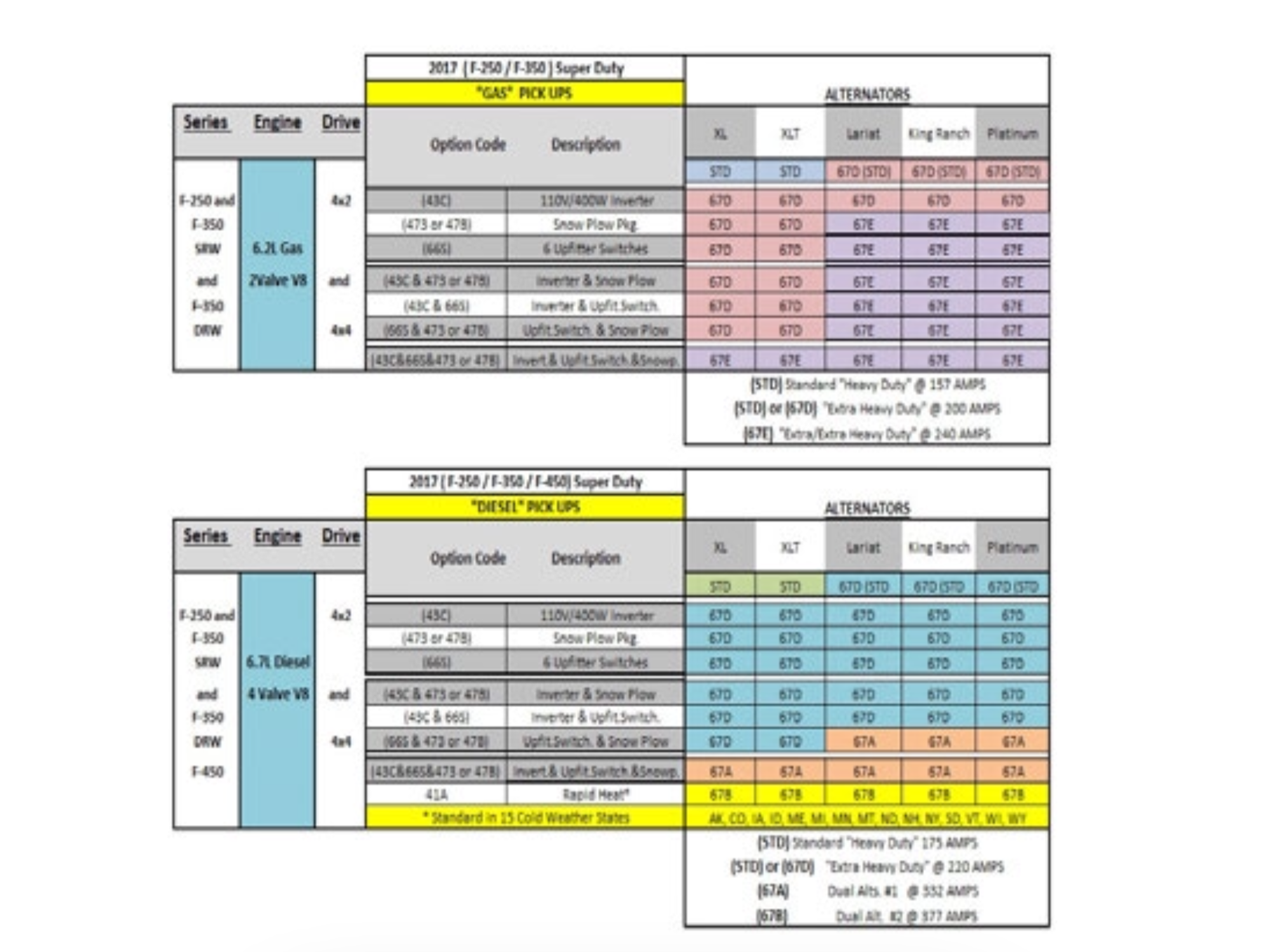

Originally Posted by RONMCHUGH
So my Lariat Ultimate has a single 240 amp alternator as I don't have any plow or supplemental heater ?
Here’s the alternator application chart for the 2017s.
HTH,
Jim / crewzer
