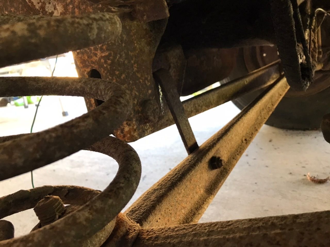

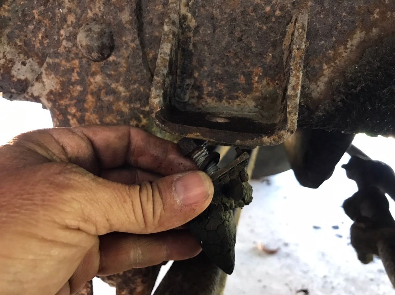

Look what I get to do.
Not sure exactly how to go about it being by myself (working alone) and I heard of some who cut the rivets but I really don’t want to go that route.
Any tips? FTLBS torque?
Thanks again,
JB

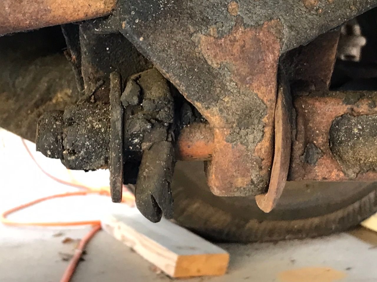

PSide:
DSide:

To My knowledge, no cutting rivets required on a 65 2wd. There are threads on here on how to do this with the radius arms in place and removed. My suggestions are to lube everything well in advance generously and, considering the poor quality of rubber replacements, go with urethane bushings.

Raise and support front of truck by frame. Remove travel stops from i-beams so you can lower them enough to remove coil springs. Remove large control arm bolt and pull beams forward until you can replace bushings.
Might as well replace i-beam pivot bushings while you're at it. I cut out old rubber with a hole saw. Cut the sleeve with a hack saw. Smooth the hole and then drive in new pivot bushings.

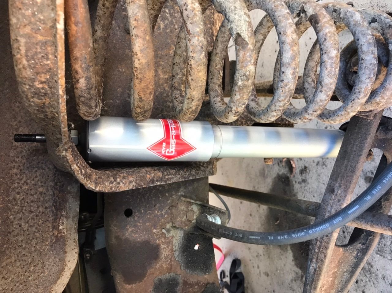

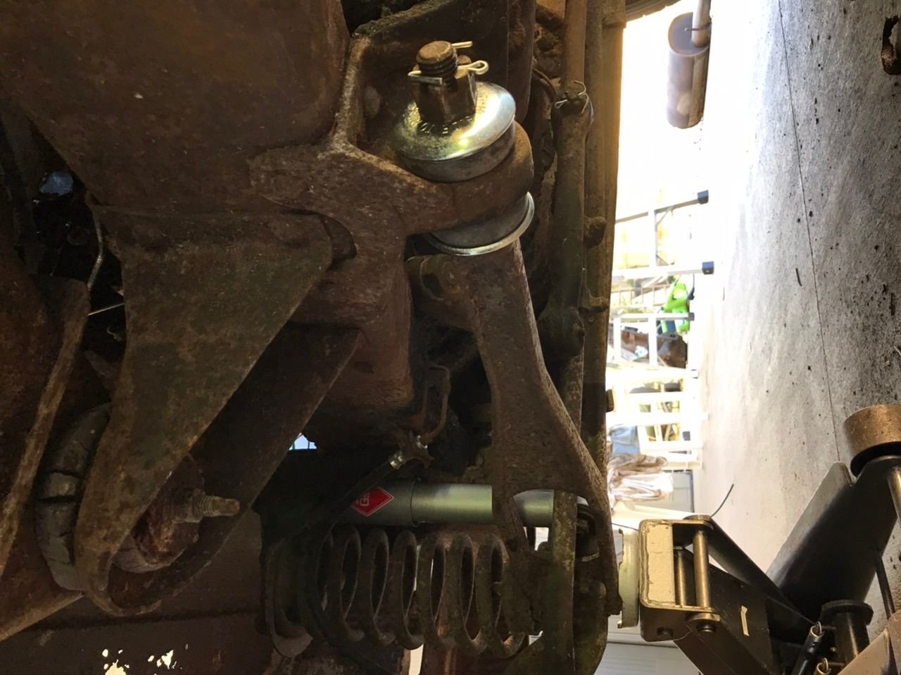

DSide completed.
Now the truck won’t bounce so much seeing the I-beam limit strap is actually doing it job and staying where it needs to be. Bushings were gone and the strap was outside the stop (new shocks help as well).
Need new bump stops as well.
NOTE: ‘65 F250 does not have a keeper for the spring at the top. Drop beam to get the spring out and make sure the top coil is in the right orientation in the cup.

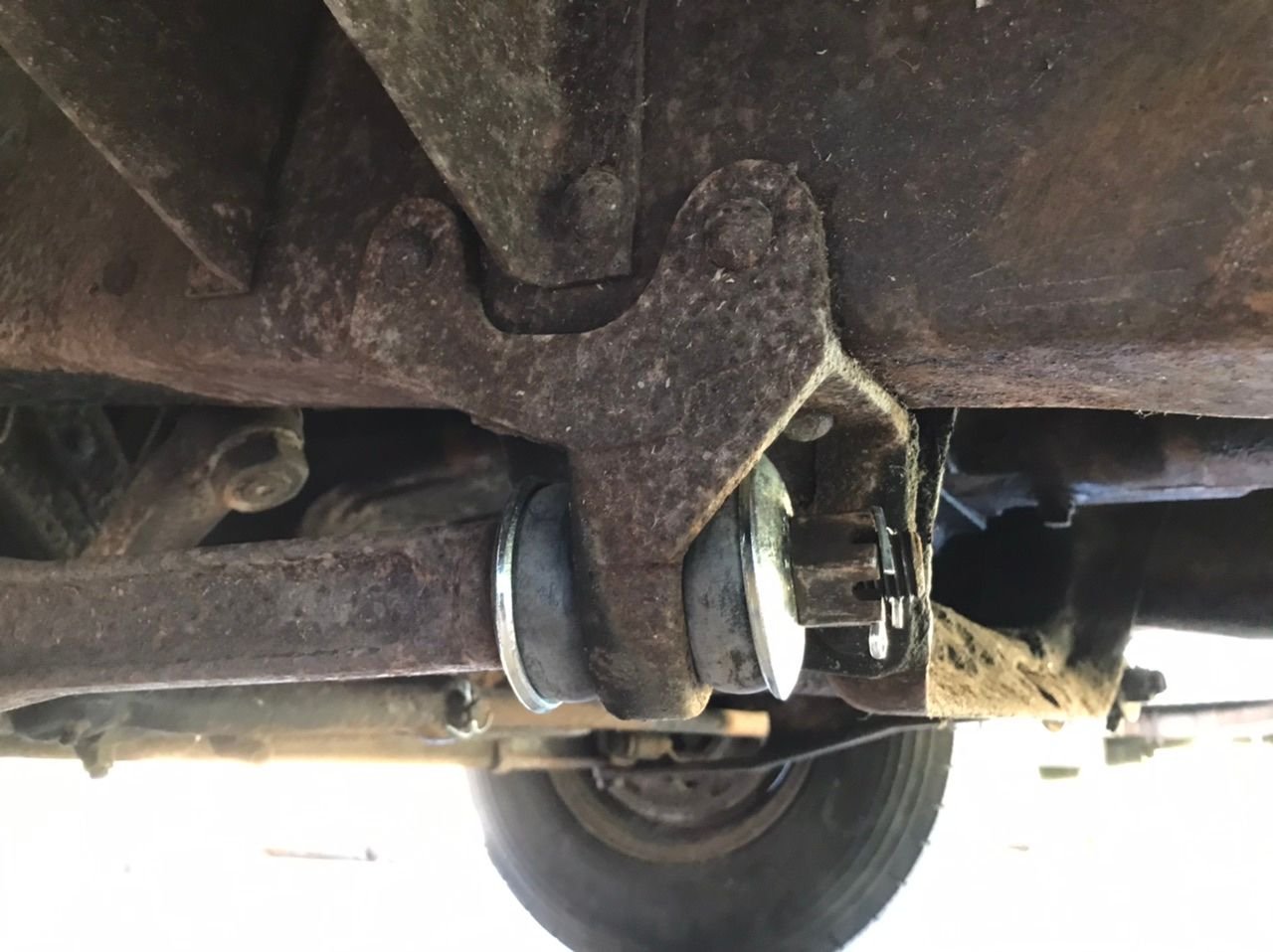

1 1/8” socket on the bushing.
Had to do a little rigging for the PSide.
Could not get it to move into the bracket.
Had the same problem with the DSide but I had something to push against.

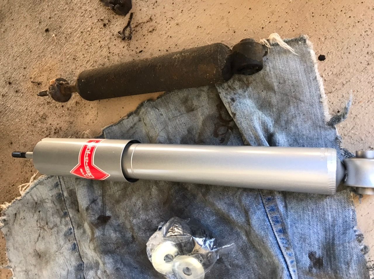

New shocks.
