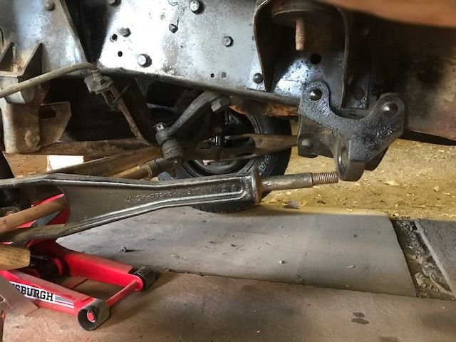

Bought my bushing at NAPA in 2017.
First time I did this as well and thanks to the crew here for the help.
I did use a ratchet strap on the PSide (2) to pull the arm back in once it was out of the bracket.
NOTE: I did use a ratchet strap to the bumper to help pull the arm out of the bracket (just lower it enough below the other etc.).
DSide I leaned against the garage and pushed and it popped in.
Note: Arm under pressure when pulling it out but doesn't move far toward the outside of the frame.
MAKE sure you put the big washers on the right way (one has a big hole, one a small and should go one way anyway).
I used WD-40 and sprayed as I did the job.
The old cotter pin took the longest to get out so I had to take a flat-head screwdriver and try to knock it out and it cut the loop end. So I worked at it and got one 1/2 of it out, then the other side of it came out-just work at it.
1 1/8" socket for the '65 nut.
11/16" for the limiter nut and 5/8" for the bolt head.
9/16" for the shock tower and I think it was 3/4" for the bottom of the shock bolt.
NOTE: Once the arm is in, just put a nut on the end (1/2 the bushing is already on the arm)(it's not going anywhere, but) and then lower to put the coil spring on, then jack it to where it is needed for the shock, THEN install the new outer bushing and nut 90ft.lbs and then I had to go just a 1/16 more to get the cotter hole lined up.
IF you don't do it this way, then you will have to do as I did on the PSide and push down on the arm to get the spring in (note the end of the spring rides into a groove molded in the top cup).
Double check before putting the tire on and your good to go.
P.S. I really like the shocks I got (Rock Auto), really helped tighten up the front/no bounce at all.
Just a side note besides DC/Mac's etc is that Rock Auto and O'Reilly's had most of my parts as I fix the truck mechanically.
Hope this helps.

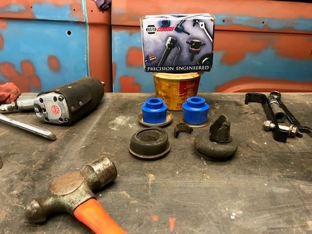

Looking at the photo in post #22 appears to be a significant difference with the original bushings to the replacement which may account for a difference in alignment. Since I replaced all of the bushings in the front suspension I made sure the components were torqued to spec's and still required some minor adjustment using my cheap alignment tool.
