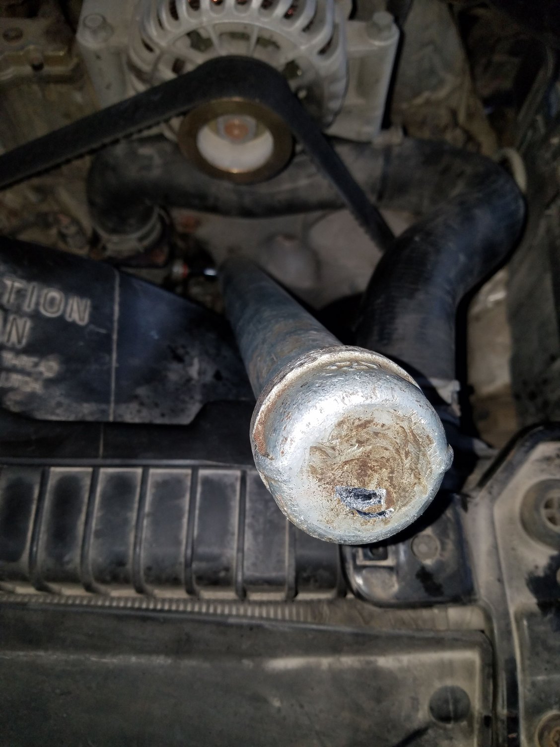

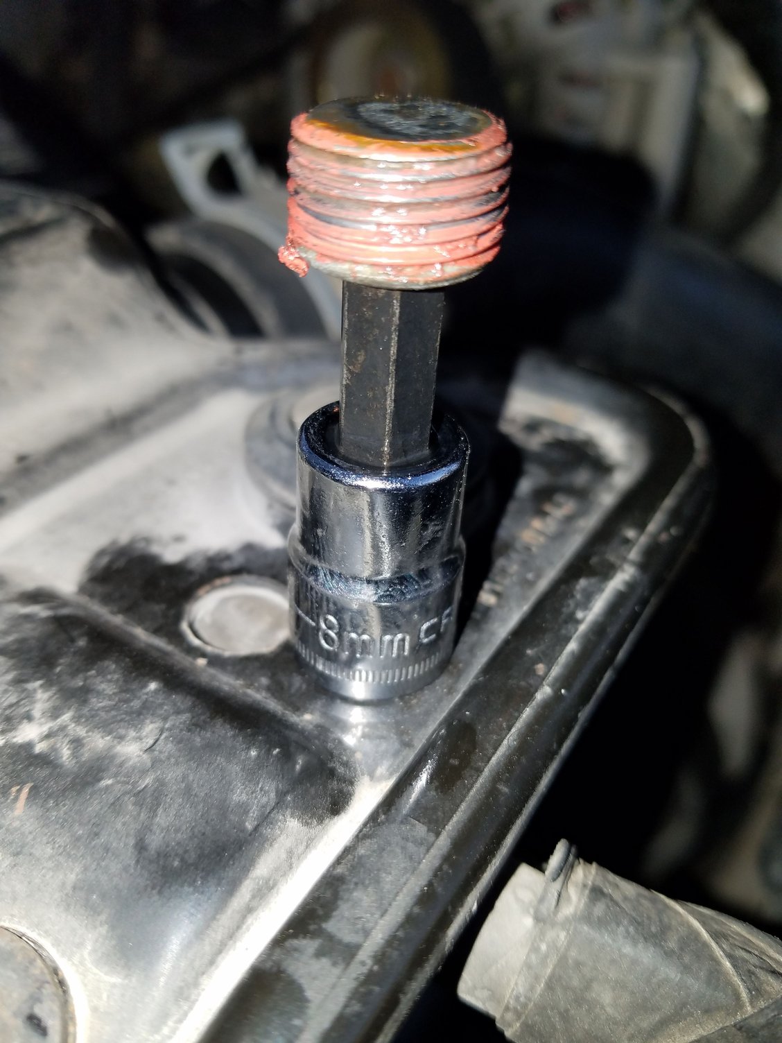

Update, I got that sucker out. I bought a few extra tools today and one of them was a set of metric hex sockets. The one I used was an 8mm. I sprayed the plug with some blaster, and then put the socket on it, with my ratchet, and then I used my trusty breaker bar, aka the pipe, and wam bam thank you ma'am, that sucker came loose. I didn't even have to warm the truck up. Victory my friends. I've attached some pics so you can see what I did.

I have a set of hex sockets and a 3' bar very similar to those. I prefer the bar with a 1/2" ratchet to remove the lugs on the truck even though I have an impact gun. Just feels more confidence inspiring for some reason.
Great job sir and good luck with the rest of the project.
Is that loctite red on that plug or just a sealant of some sort? Loctite red makes removal a challenge without heat.
