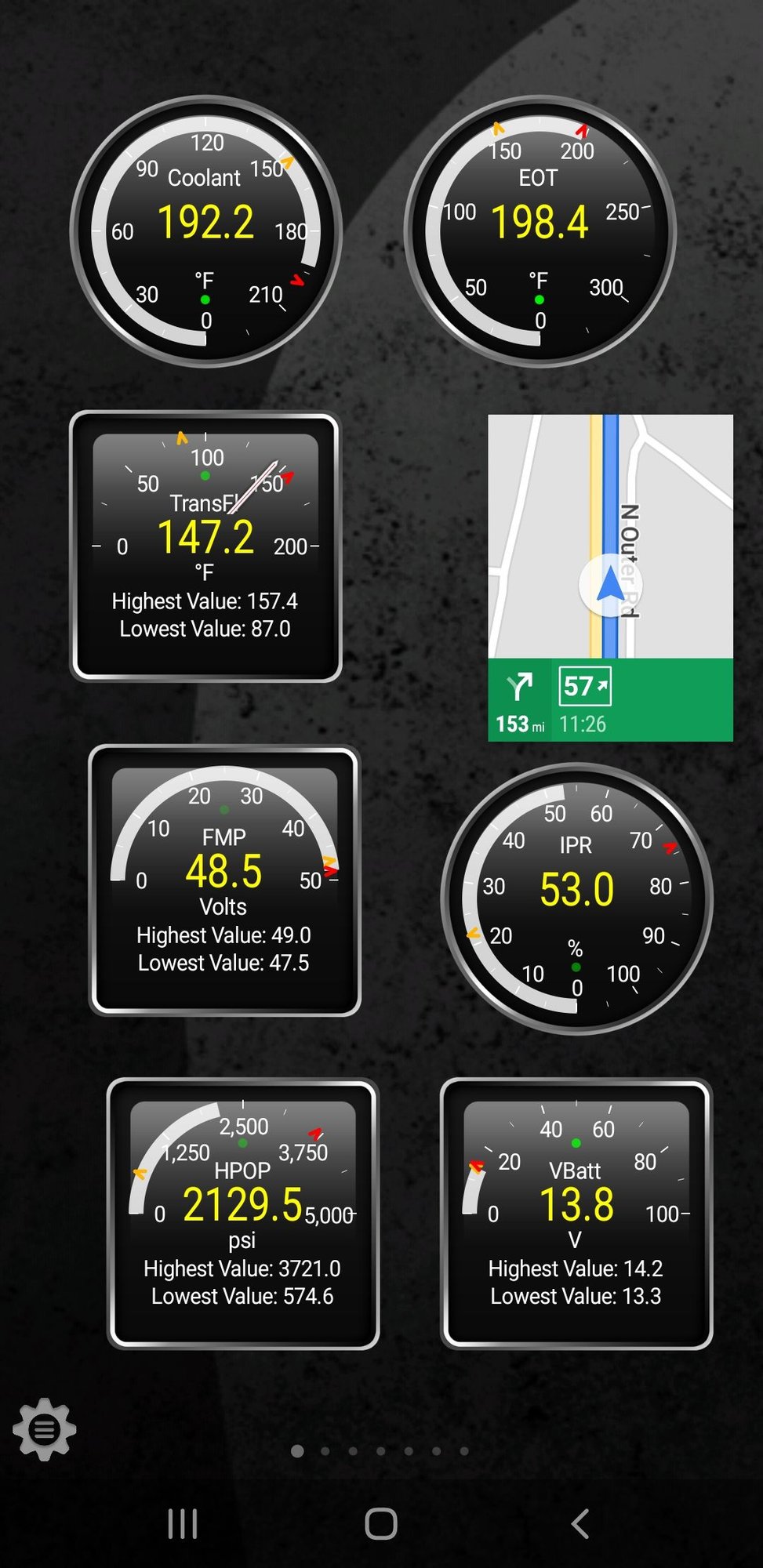

I am new to the 6.0, I have a 2006 f350. I just had my oil cooler replaced maybe 2000 miles ago. Driving around town 30 to 40 mph it maintains a 3 to 4 degree difference. When I hit the hwy and go 70+ mph it jumps to a 6-8 degree difference. Coolant temp 192 -194 degree the oil temp would get as high as 202 degree. Pulling nothing outside air 50 to 60 degree. Is this normal with a new oil cooler? It just makes me wonder what it's going to be when I pull my camper in 90+ outside temp. What is normal oil temp and what is getting to hot?
This is cruise control set at 75.

I just did a 250 mile round trip on pretty flat freeway - kept it mostly in the 65 - 70 range as that was the least hassle (not keeping up with the all-gas and all brake left laners, and letting the trucks and other tow vehicles do their thing on the right). I'd hit a high of 8 or so deg between oil and coolant, mostly because the coolant would drop for a bit to 188. It usually gets stable in the 190.4 (don't you just love our digital real-time world?!) range. But the oil was sitting 196-ish or so... Empty and light on the throttle for most of the trip. Temps in the mid to high 70s...

You’re fine, send it!
