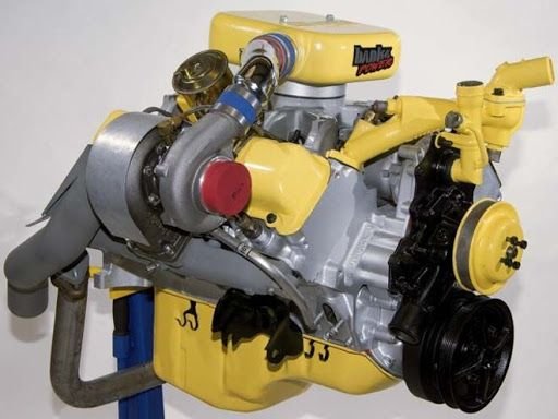

the best install is probably on the back of the engine... like this picture...
I see no need for headers BUT IF you Must then I think you would want Torque Tube Headers...of course with the best Manifolds the exhaust would exit the center facing up on both sides with the turbo mounted in the engine center or maybe Twins one on each side ... as mounting in the center of the engine is problematic without a lot of Custom work.

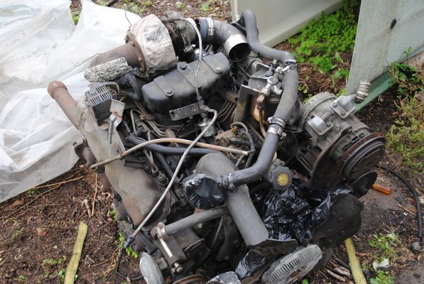

Note the way this turbo is mounted...

Looks like it only runs off the right manifold, and the left bank exhaust crosses behind the engine.
Now if you had a Turbo on ea side, that would build some oomph...zoom.....zoom.....
Sure would cook the return lines and warm the fuel to the Injectors.

that system runs driver side exhaust into the back side of the passenger manifold
