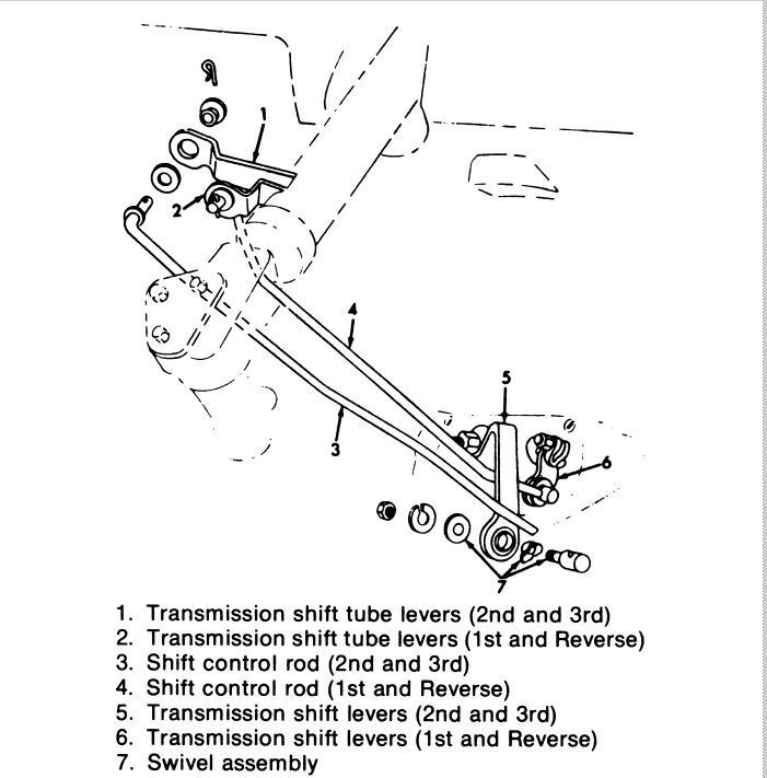

aside from the two I see in the engine bay, where are the other two located?
Old Mar 1, 2020 | 04:38 PM
Capjack01's Avatar
Capjack01
Joined: Jun 2017
Posts: 106
as I recall, at the other end of the shifter rods. as in the other end of the ones on the column, connected to the trans shift levers

ok, seems the lower part has swivels instead of bushings, but I vaguely remember doing those as well.

Okay well that is a very helpful diagram I haven’t seen that one yet and haven’t looked under the truck

1965/72 F100/250 3 M/T shift lever bushings.
Originally Posted by Capjack01
#2: Im betting its 3 on the column, yes?
My first one did so all the time, change the bushings, I think there's TWO.
No bushings where rods attach to transmission levers.
Bottom of the column underneath the hood are the two manual control selector levers where the shift rods from the trans attach.
In each lever is a rubber bushing and insulator. Over time the bushings crack apart, causing the shift lever to bind up between 1st and 2nd gears.
C5TZ-7343-A .. 3 M/T Selector Lever Bushing & Insulator Kit / Obsolete
1965/72 F100/250 2WD // 1966/72 F100 4WD
GREEN SALES CO. in Cincinnati OH has 8 = 800-543-4959.
CARPENTER NOS OBSOLETE PARTS in Concord NC has 865 = 800-476-9653.
