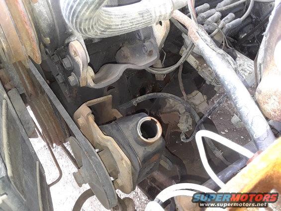

I pull every Saginaw setup I can for SBF, BB6, and BBF.
For a 300, the v-belt saginaw bracket is it's own piece that fits with either the York or Sanden/wobble plate style AC brackets. Or, with a nut as a spacer, it fits without any AC bracket. I've pulled both style AC brackets, as well as a "home made" one for a York. All mount to the block with 4 bolts down low. One of which is shared with the Saginaw bracket, which is put on after the AC bracket.
I have a Saginaw in my 85 bronco, without AC. I am currently adding a York for OBA in the factory position with a factory bracket.
Let me know if theres anything I can do. I have a spare 300 sag bracket set, but no pulley for it. The pulley must come from the same style engine. A SBF one wont work on a 300.
Oddly, I've seen two types of Saginaw bracket for v-belt V8s. One is a big honkin ugly thing found on SBFs. The other is much smaller and better looking. I've pulled this one from both a 351w and a 460.
I pulled one from a 76 f100 with a SBF too.
300 with most of the wobble plate style AC compressor brackets and saginaw still in place.
York and brackets
