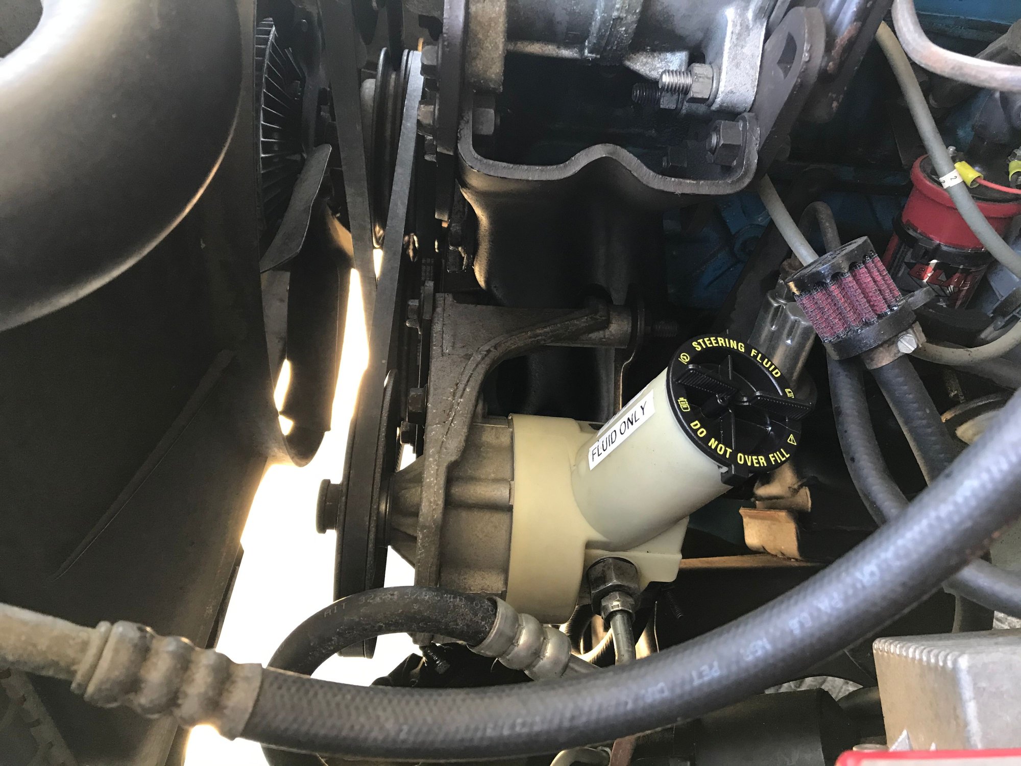

I say this because the AC brackets for a Sendan compressor and the Saginaw PS pump on my 81 300 six I am told came from a van of the 83-84 and maybe other years.
PS pump with out AC bracket
With AC bracket
Dave ----

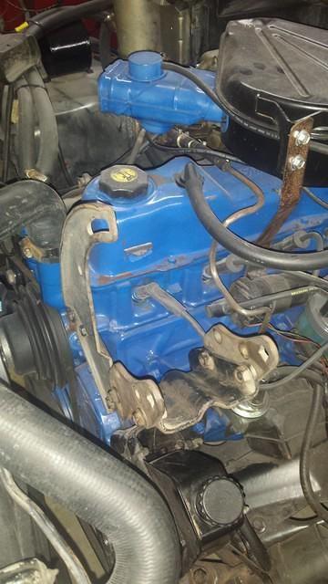

Stock bracket !

That AC bracket looks to be the same one I have on my motor.
The early trucks used a York compressor and a totally different brackets.
I would say just look for the PS pump & brackets you want and should bolt right into place.
If you come across another flat bracket that the compressor bolts to and the flat bracket then bolts to the main bracket bolted to the motor I can use one, willing to pay for it.
I don't have a compressor yet and thought the flat bracket was bolted tight to the main one.
Well it was not bolted good and fell off, by the time I knew what the noise was I heard the week or 2 before I could not remember where it happened on the road to go looking.
