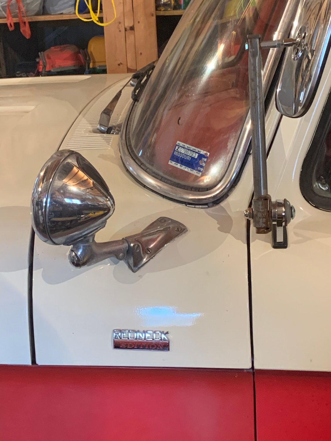

From: South of Yankee Territory
As I understand it they were a dealership option, installed by the dealership for the customer. I’ve got one on my 61, mounted on the left side. I’ll try to get a picture for ya. Actually, I’ve got two. I picked up a complete assembly for 14 bucks at my favorite consignment / antique shop.

Old Feb 25, 2020 | 10:22 AM

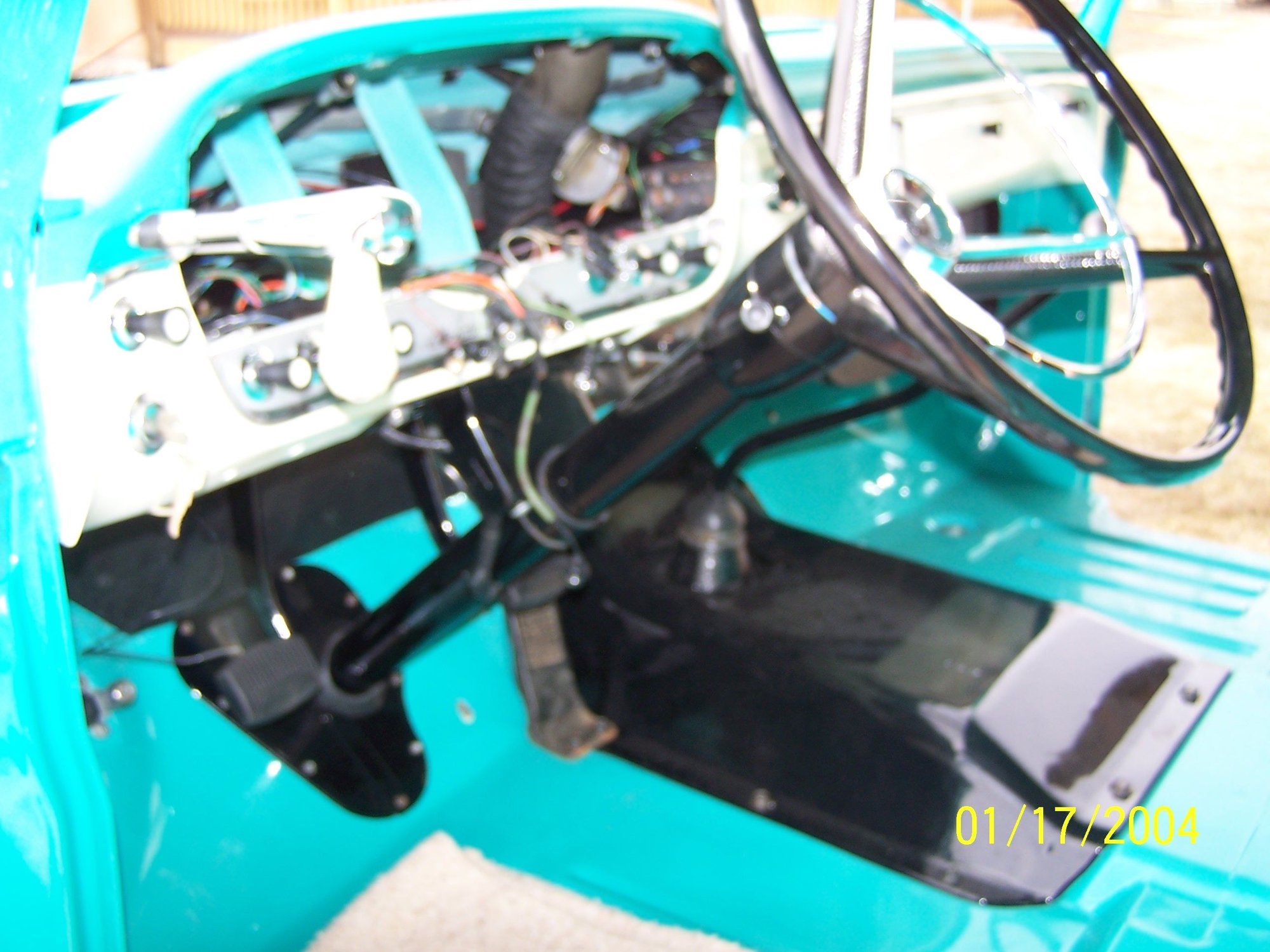

You can get the outside mounting bracket from Unity spotlights for about 100 dollars, Comes with the template to tape to the cowl to drill the mounting holes. You can also get the complete set up from them. Don't know price as all I needed was the mount. Cheaper new than to get it rechromed

P51, Thanks for the pics. I was thinking it went through the hole above the key, while my coworker insisted it went through the A-pillar
but that seemed like it would be a bad idea, structurally. Nice badging BTW!
Skidoorulz, Nice pics, nice slick! Got a question. Obviously a Customcab, I see you have the round speedo like mine and the panel below there with the CustomCab script. All original? 66? Where is mine on my 65 CC.

Mine is a 64 Custom Cab. Notice the difference in the steering column mount. I believe a 65 and 66 CC used an entirely different speedo for the CC. Standard cab used a round speedo with a white bezel. The mounting bracket on your spotlight is not the correct bracket for 61 to 66 cabs. Yours is for an earlier model possibly around 56 or so.
