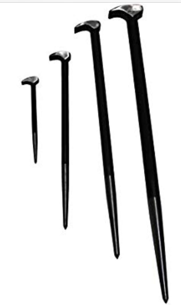

I use one of these. Seriously.
Do y’all just let oil run down your arm and all over filter, etc???????
