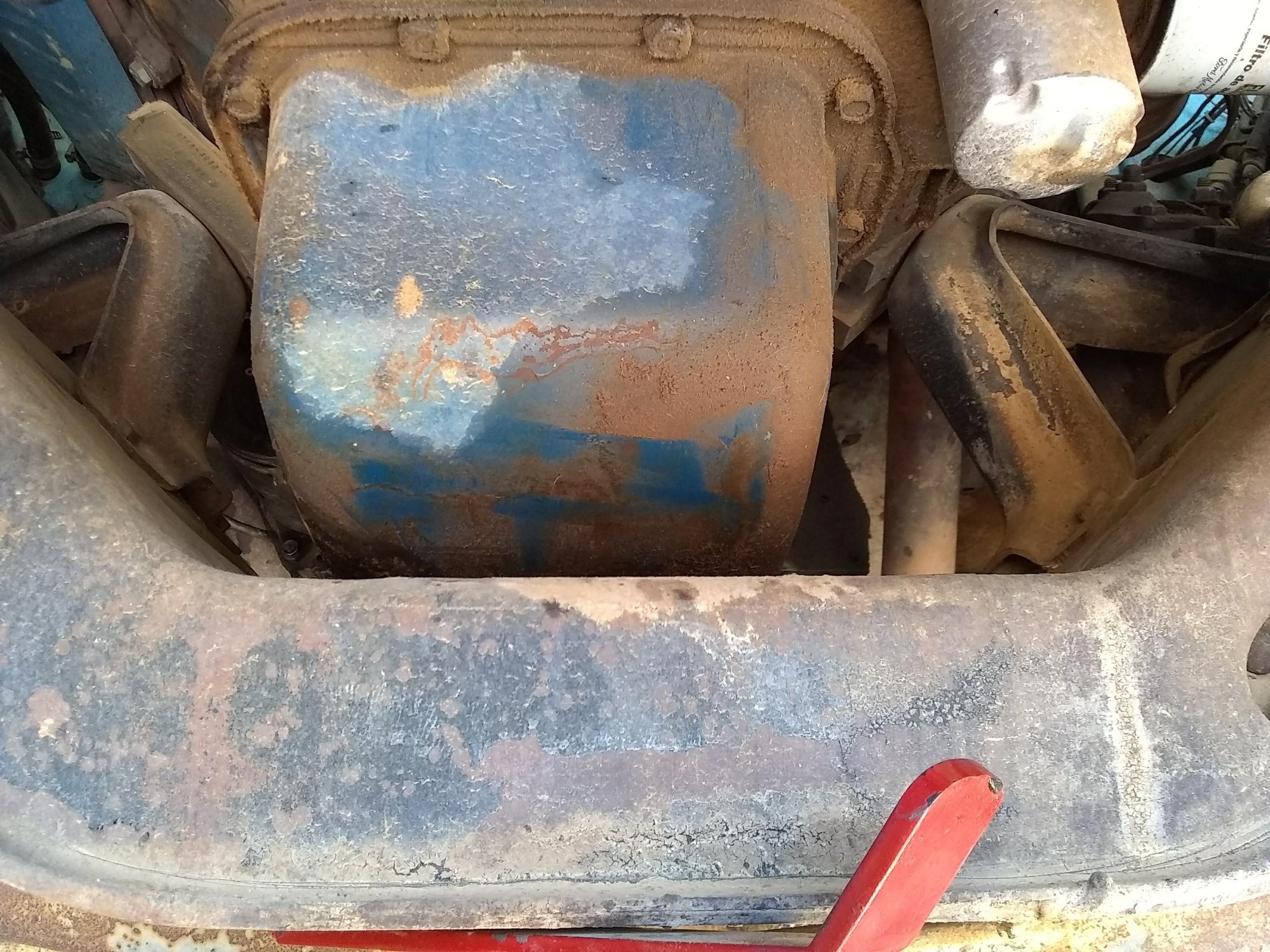

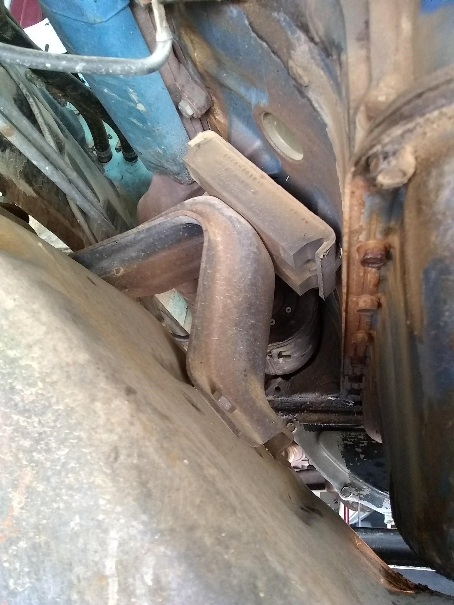

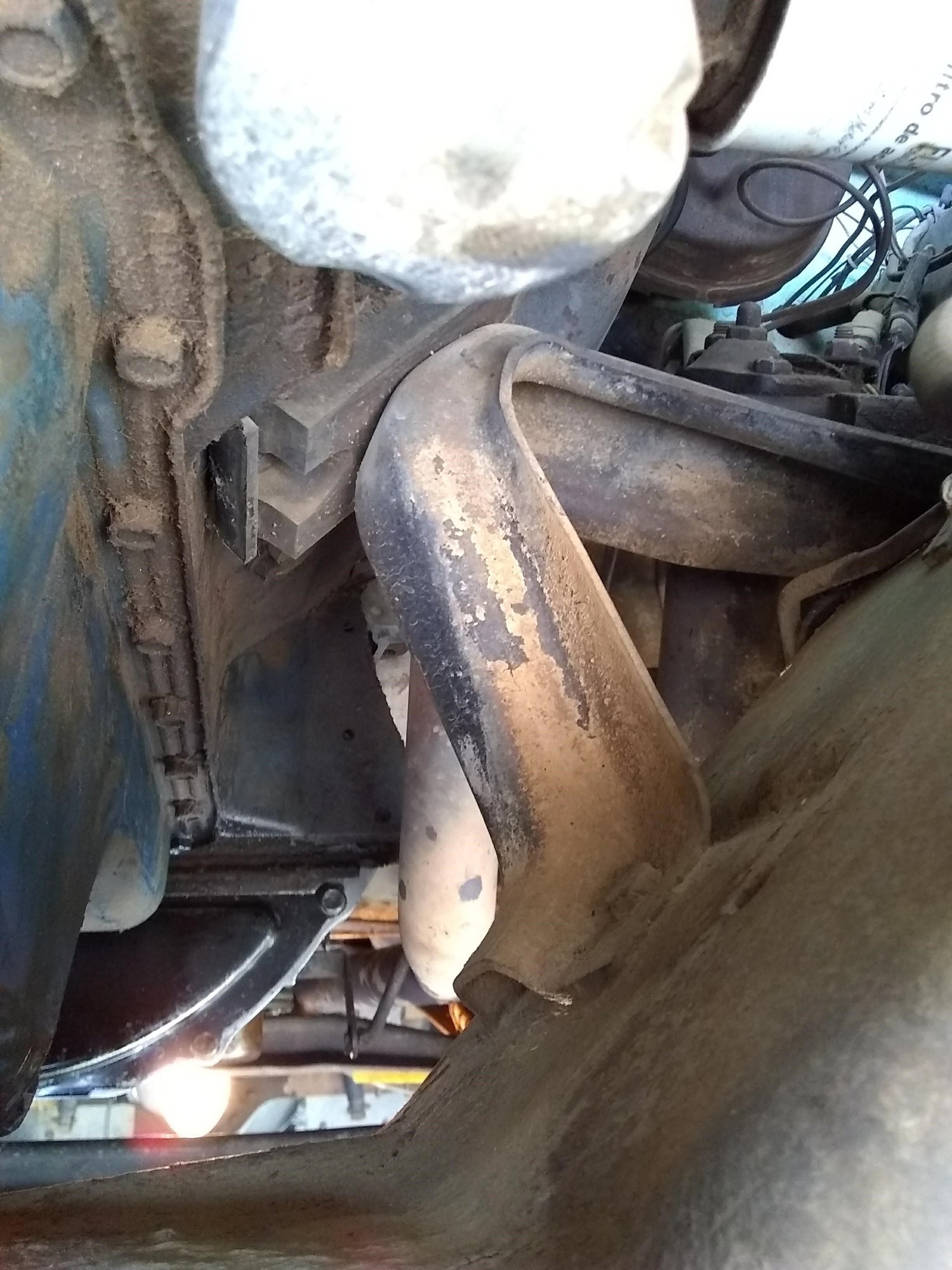

I'm not sure what you guys are seeing but that motor is just laying in there up against the firewall. Not even sure there are motor mounts. On the driver side where would you put the oil filter adapter.
Happened to have my truck on the lift yesterday finishing up the install after rebuilding my C6. This is what it should look like (but prettier when you are done.)

Those are very good detail shots, thank you jfmaz!
Sure mine are the correct brackets now. You know of any 'best' place to source the insulators or motor mounts??
I see that you have the horizontal oil filter mount. Looking for one myself as my engine (to be) was an automobile engine.

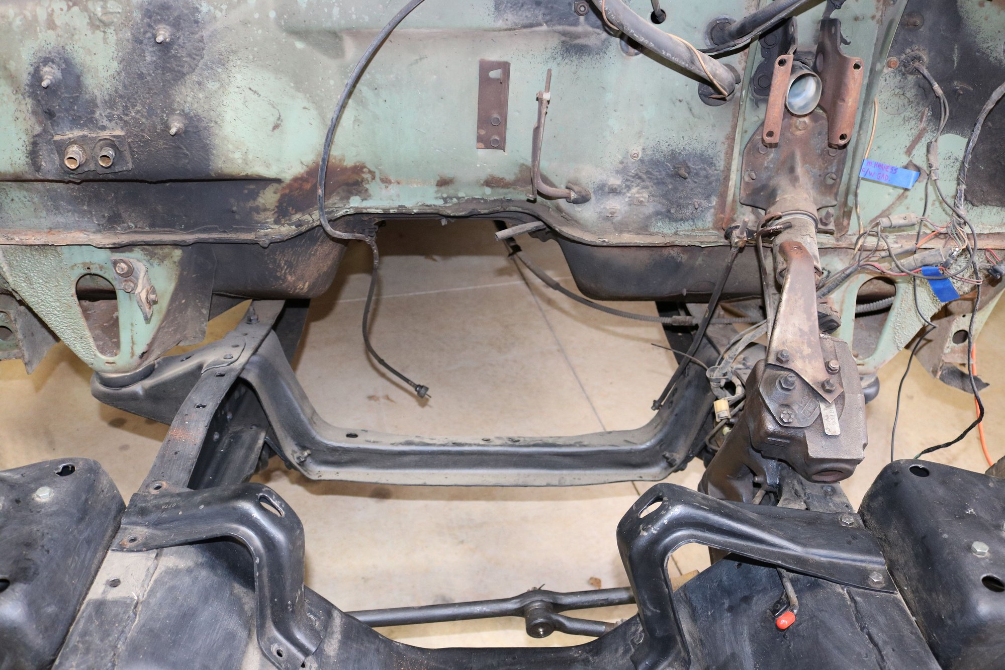

No pics to show right now, but the passenger bracket was too far forward, as many suggested. There were more lower holes underneath it's too forward position, so when bolts were out, it was pretty evident that was the case. Using the 'square' hole on my frame top as the rear most position. Engine should fit right in now. Pics of before and after when I get my isp back...

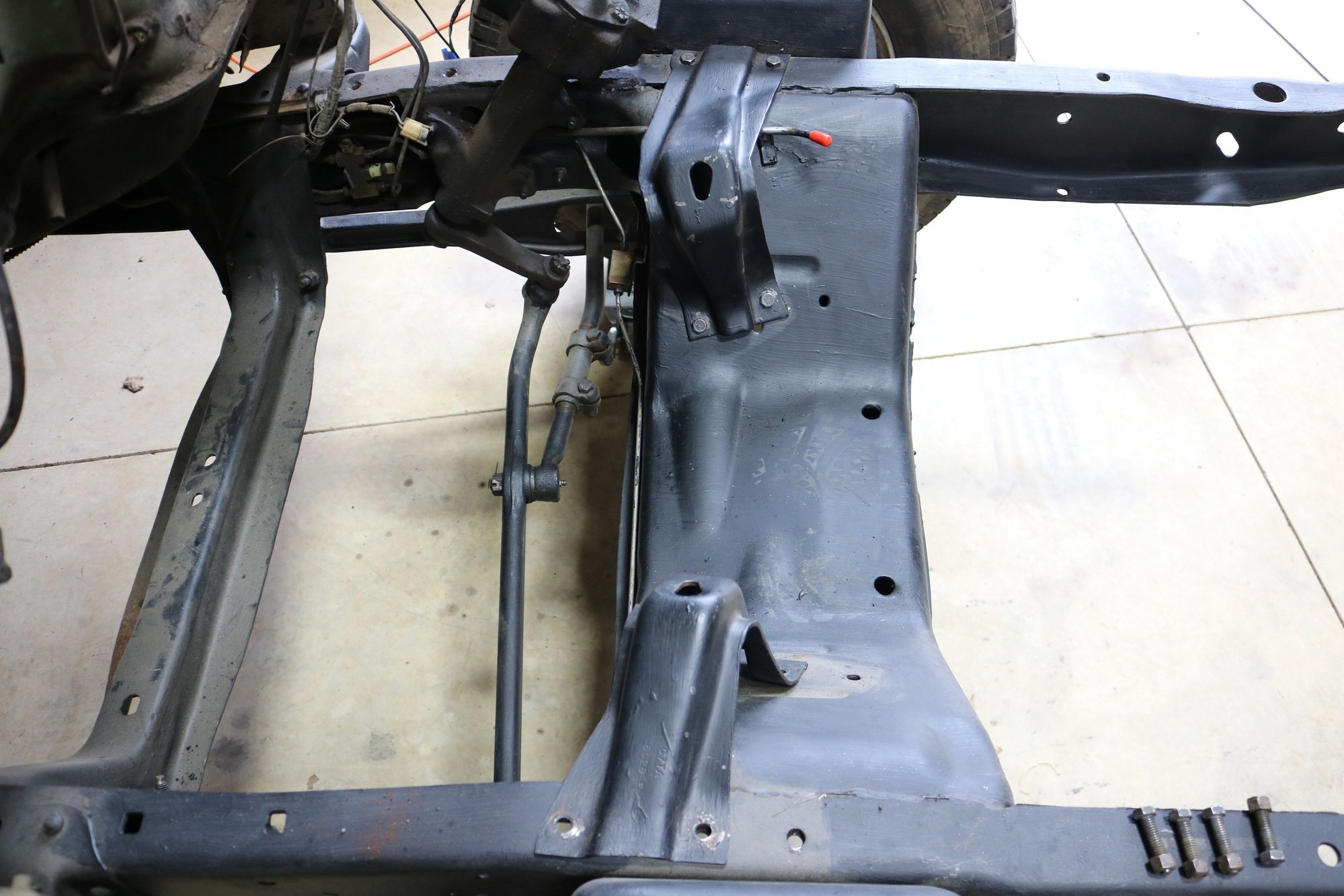

Here we go! Bolt positions were simply wrong. Maybe put some grade 8 bolts in there after the first 50 years.
This is how I got it.
Here with the passenger bracket shifted to the rearmost holes. Looks like its ready for that rebuilt 390 now. Anyone know whether that far bracket will accommodate a power steering box?
