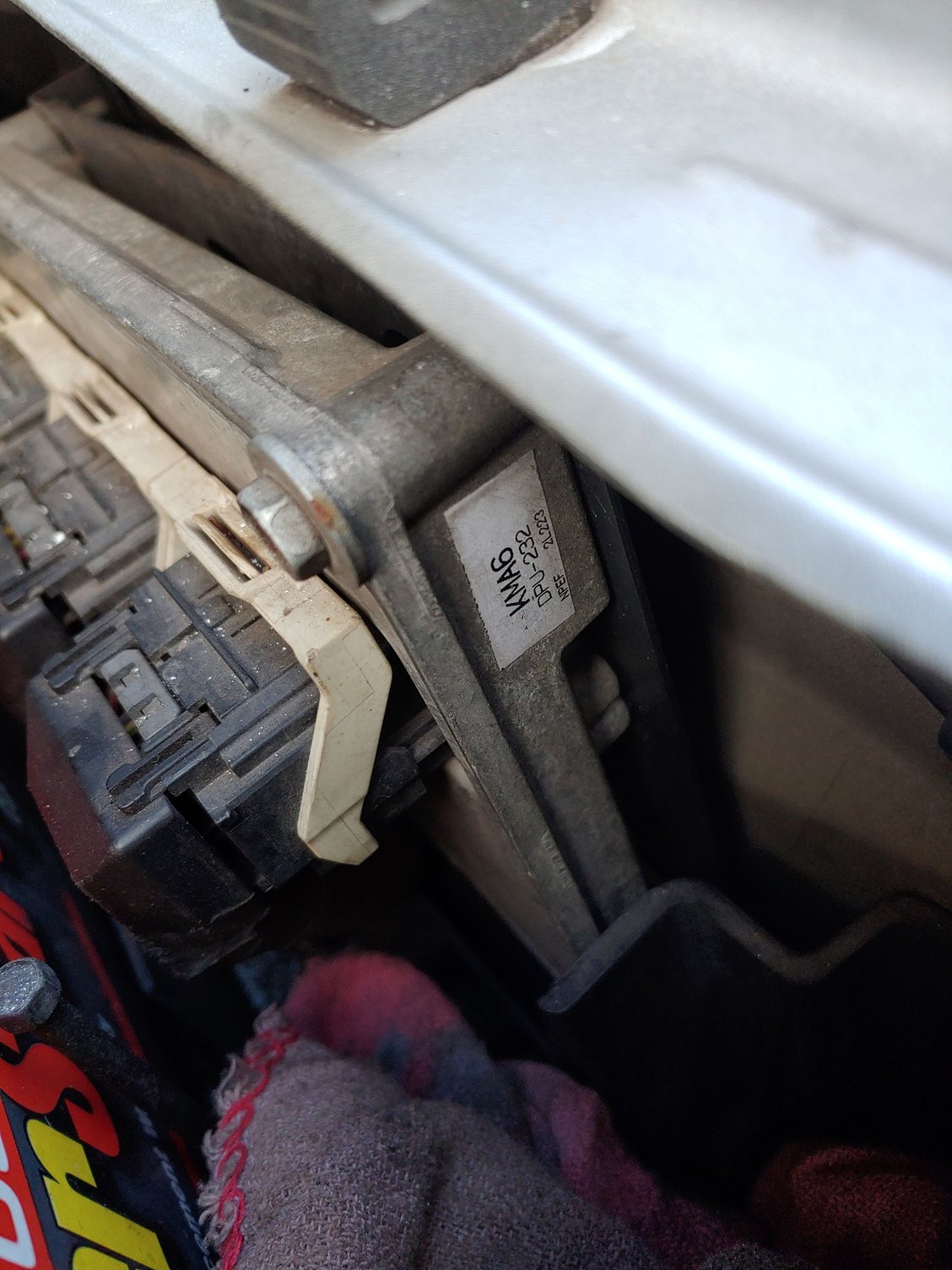

which sensor sends a signal to the FICM to energize the glow plugs , truck is a late 04 ICP in valve cover, new glow plugs, harnesses and control module. Running 5-40 synth, starts great when plugged in , long crank with 6.4 starter till it fires off runs ruff for a second then smooths out

The PCM activates the glow plugs by communication with the GPCM. Primarily oil temp dependent, but PCM also looks at battery voltage, and Baro according to the PC/ED.
Oil must be 131*F or below for glow plugs to operate. Above 131 *F, the PCM will still bulb-check the Wait-To_Start light.

so is the PCM part of the FICM or is a separate box and where is it located, I just put in a new oil temp sensor when I did some work and fixed a leak not one of 3 dealerships could find when the truck was new.

The PCM (Powertrain Control Module) contains the ECM (Engine Control Module) and the TCM (Transmission Control Module), The PCM communicates with the FICM (Fuel Injection Control Module), which is a separate module. The PCM sends the FICM the appropriate engine parameter data (from sensors as well as calculated parameters) necessary for the FICM to properly control the injector operation.

Pcm is on the drivers side fender wall. GPM is under your icp senser on the passenger side valve cover. So many abbreviations ya can't keep track.

ok I change the GPM , now to check the PCM connection so many abbreviations, so you southern people don't ever use you PCM especially in southern Florida.

The Glow Plug Control Module is abbreviated GPCM, the PCM is the Powertrain Control Module. It, the PCM, will tell the GPCM when the glow plugs need to be on.
It is used on every cold start (unless the oil temperature sensor is bad and reads over 131 *F. It may not be 100% required on 40* starts, but it helps.
