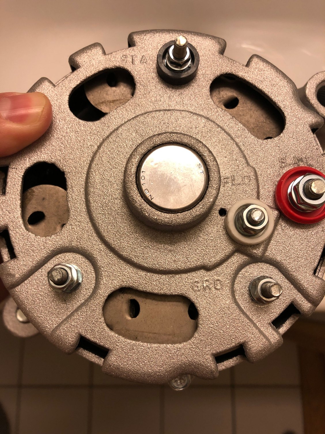

I kind of understand what you are explaining to me. Those FSA? They all come from the dash right. When you are saying ”constant power”, can I just route one directly from bat positive then?
No, only one does.
The colors I gave were for the original harness, but assuming you still have some of that left you can use it as a reference when you put any new wires together.
The Green w/red stripe "S" wire comes directly from the ignition switch, so yes it's from the dash.
But the Yellow "A" wire is the voltage sensing wire and should be attached somewhere near the battery. In the factory harness it is spliced into one of the Black power wires somewhere under the harness tape. But you can route it to the battery positive in any way you feel is convenient and reliable.
The Orange "F" wire terminates at the voltage regulator on one end, and the alternator's FLD stud at the other end. No connections with any other circuit. It's the wire that lets the voltage regulator tell the alternator/dynamo how much current it needs to produce.
