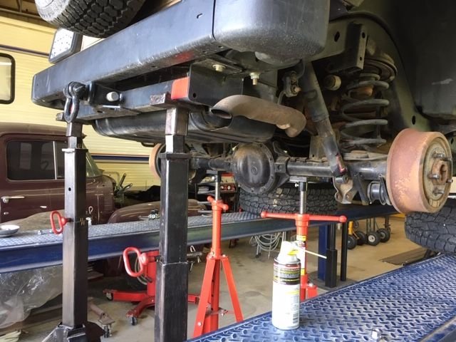

I have had a four post hoist for 20 years. You will not regret it. Do a lot of measuring in the area you intend to put it. Go for the long version if you can, you will be glad if you ever buy a long box ext. cab pickup. Make sure you allow plenty of room to work around the vehicle on the lift. If you can't afford the rolling jack, you can make some heavy stands like I did, those along with lighter stands for the axle let you do all sorts of brake and axle work.

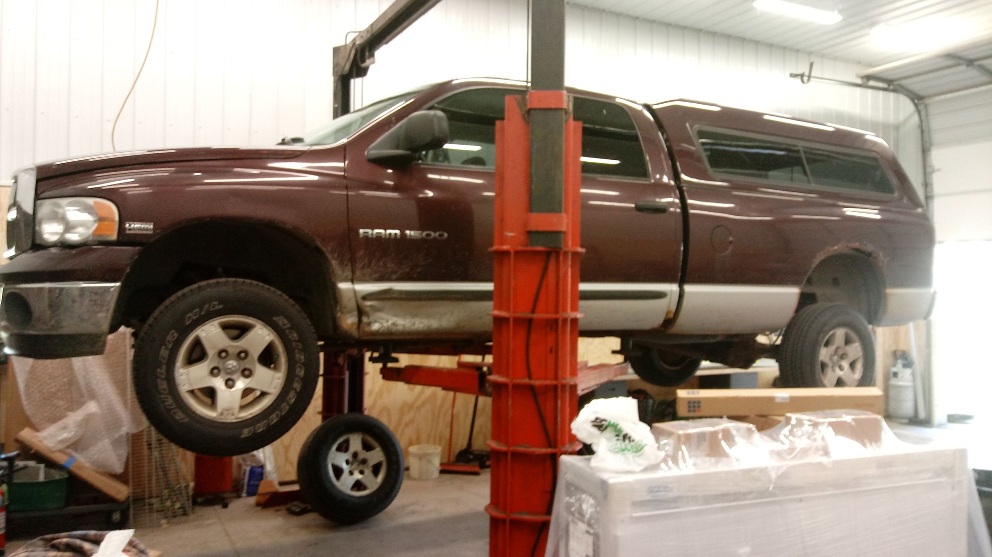

I am a 2 post fan, unless I had room for both! IMHO buy a 4 post if the primary reason is for additional storage. Buy a 2 post if the primary reason is to work on a vehicle. Better access to work on a vehicle with a 2
post, easier on and off with a 4 post. In my case I bought a good used american built Rotary 2 post asymetric lift about 10 years ago. I should have done it when I built my shop/barn 26 years ago.

I agree with Bill. I bought a used Manitowoc lift about the same time as Bill bought his. My knees and back thank me every time I work on a vehicle. It be kind of unnerving the first few times you raise the vehicle up, I have an four door truck with an eight foot box so it's about as long of a vehicle as you can get. I always place a screw jack under the back bumper for stability.

I have the bend pak 900 four post and am very satisfied with it. I don't see an advantage to a two post lift as far as accessibility, I have pulled rear ends, engines, transmissions, not much I have not done with it. I also just drive up and it is done no bending over adjusting the arms to the so many variables of car frames. I do have the air operated jack which makes tire removal a quick process. Get the extended ramps for the lowered cars. I have 78 inches clearance under the rails in the locked position and can get 82 all the way up, so I can walk right under it and also work under it. It was delivered to my door, I did have to guarantee I could get it off the flat bed truck. I bought from the Bend Pak dealer out of Los Angeles and it was about mid range in cost to other brands.

I have truck lift extenders that came with my lift. I remove the rubber pads and the extends fit over the lift pad. With my F-2 there isn't much clearance between the arms and the bottom of the boards.

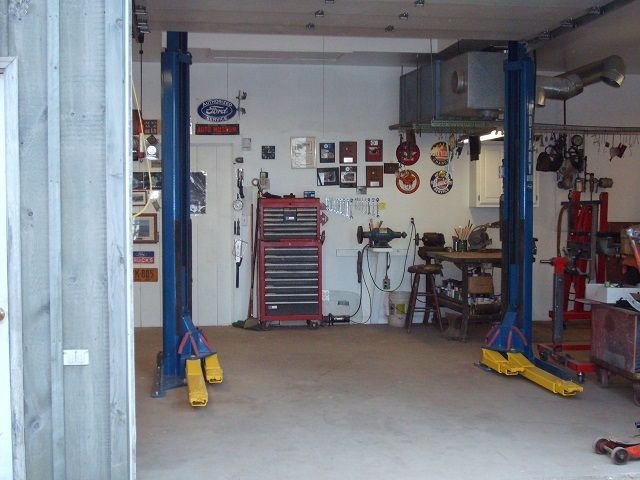

Each type has it benefits and distractions. For me I like the two post because when I'm not using it the two post have as large of a foot print so I can work on other things. For example I have two projects for my business going on in my shop now. I am able to easily remove the lift arms on my lift and place them against the wall. I move things around with my forklift in the area of my lift, only concern I have is the two posts they don't take up that much room themselves.
Aligning the arms under the frame can be a pain but not too bad. A lot better than lifting with a floor jack and positioning jack stands and then having to crawl around on the floor trying to see what you're working on and having dirt and rust fall in your face. If I had my choice and room I'd go with the four post with the accessory rolling lift trays. As mentioned, you do get extra vehicle storage with a four post, I don't have a lot of clearance under my two post to drive a car under, I don't think I'd really want a car under it for extended periods of time anyways.

I really prefer a 2 post hoist.
And by the way had a Caterpillar 262 skid steer on it just last week, no problem at all.
