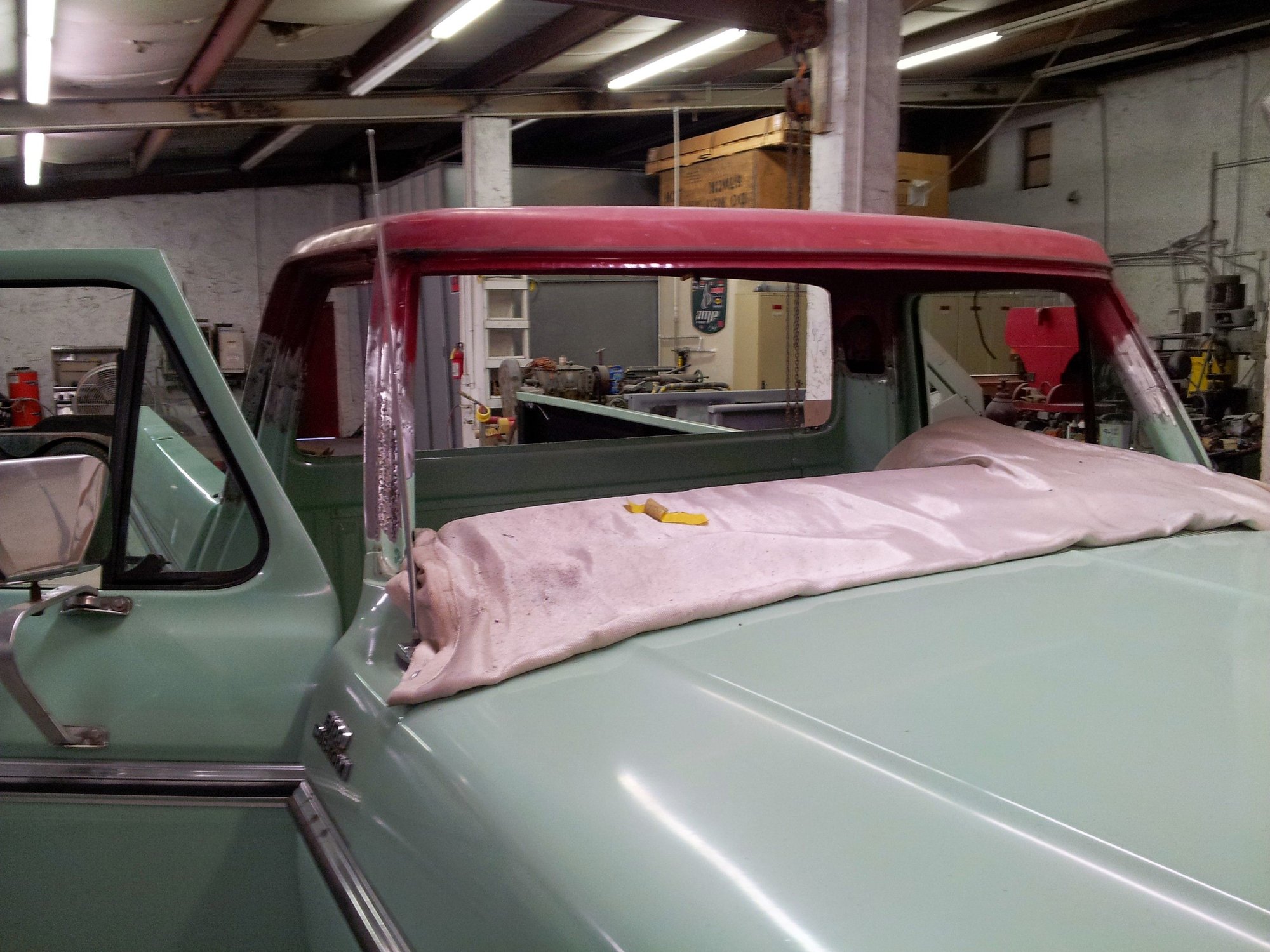

Here is what I’m looking at
I was hoping to get the truck fixed to the point where at least I wouldn’t have any water coming into the cab and I could put in carpet. So I contacted a body shop and the guy looked at the pics and said he can’t get the necessary panels to repair this and he can’t fabricate either. Do you guys think there’s anything that can be done apart from getting a new cab or finding a decent donor cab to cut out the pieces I need?

It could be done with donor parts but consider how hard it is to find a good cab , or find a better fabricator to do the repair , ,,If it was mine , I have average welding skills and I would try and do it myself if it was mine , get a good mig welder an new metal and go to town so to speak, cut some pieces an weld in , grind an sand little filler on surface area were needed and it can be made to look good,,it is work but can be done , , most will be hidden with seal , just take the time to mold it in there to the right contour ,

You need to be shopping for a new cab. That is structural support rust, and no amount of cutting/grinding/patching/coating will make it go away.
What you are looking at is 2 gallon cans of fiber-strand Bondo, a bunch of rebar and steel patches and caulking holding my roof and windshield together. Every year or so, a new hole appears, as the rust is growing from the INSIDE. And every year, it gets another patch and more Bondo. It does not leak, but it does not last nor is it safe.
Mine is a work truck, so I don't care much. It is a supercab, so it is extremely difficult to find an affordable, rust free replacement cab. It IS a safety issue, and both you and I should be replacing our cabs as soon as possible.

From Harbor Freight, purchase a Sheet Metal Brake and a Shrinker and Stretcher (I'm assuming you have a MIG welder, although a wire welder would work too) and get you a pile of the right gauge sheet metal and go to town, become "the guy".

Yes. Opinions may differ to mine. While you have already invested some money you are still farther ahead to bail out now. It will only get worse both in money and frustration. You can buy a replacement cab but that is a lot of work and if you can't do it yourself paying someone will be expensive. Some folks can swap a cab no problem because they have experience, tools and place to work but it does not sound like that's you. Extensive rust is no picnic even if one knows how to fabricate and weld. I've done enough of it to know and have no desire to do more. Even though I'm in PA, I finally wised up and quit buying rust buckets 20 years ago after buying and old car from CA and was awestruck how everything came apart like it was just put together a week ago. I spent $1200 to have it shipped but that was a drop in the bucket to what it saved me not having to deal with fighting rusty bolts, rotted floors, radiator supports, trunks, or quarters, etc. Point in saying that is whatever it costs to get a rust free truck to start with is usually well worth the extra money and far less expensive in the end. Buy Once, Cry Once, the quality remains long after the price is forgotten.
The truck in signature is from an arid climate. I installed a windshield and the original pinch weld was literally like brand new still shiny red paint and not even a spec of surface rust to be found. Just one of many examples how much easier it is to work on a rust free vehicle.

Find a new body shop. If tracking down donor sections or fabricating simple bends and channels is out of their capabilities, I'd look elsewhere.
Or, track down the sections of a rust free cab (or an entire new cab) yourself and bring it too them. Seems like a straightforward problem to solve...

X2 Find a body shop that works on old vehicles (Broncos, Chevy trucks, etc) that are also prone to rust. They'll pull the windshield, cut out the rust and bend up/hammer out a new piece if they can't find a donor. I've seen much worse.

Actually you can cut the rust out after removing the windshield , just cut enough to get to all rust and then you can mold in the new metal , there are some hand tools that can help with the right bending or getting proper curve of the metal , the bottom lip is were 2 pieces of metal meet an spot welded together , you can replace that with one piece of metal to match the thickness properly , you can easily cut the top skin of roof of metal , the inside will be more tricky but can be done , anything can be repaired its just a matter of cutting out all the bad rusty areas of metal but you will need to get to all rust for proper results , if you go through some of the build pages you will get many good ideas , mine can give you direction but there are many better ones on here, I have been looking for this one build but cant find it yet , its a member not in the U.S. and harder for him to get parts truck , but his fabricator did some awesome work and rebuild windshield area and much of the cab areas most would not even attempt , if I can find the link I will post it,
