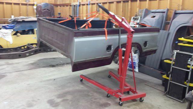

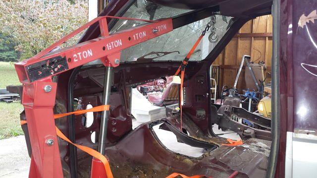

I don't know why I did not think of the picker as I used it for my parts truck cab. I did not use the wood as the cab was a roll over and I did not care what happened.
I did use 1" ratchet strap(s) to keep it balanced. I could not use the picker on the good cab because of room in the garage at the time.
I also used the picker for the bed using straps again.
When you are rebuilding a truck and have no help you have to get creative.

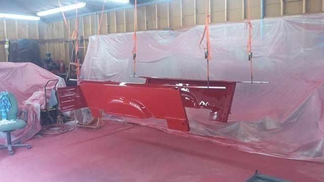

My garage has rafters I have used to hang parts from like the cut down bed to just the ribbed floor and when painting like the bed side panels.

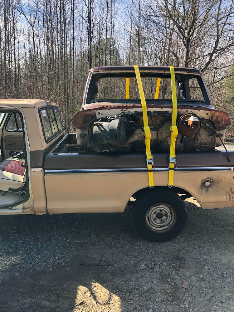

So I drove my truck 450 miles yesterday. I’ve never taken a road trip that long in the truck. It was very difficult, but worth it in the end. I was prepared for how noisy my truck would be at highway speeds, but I was a little surprised by how cold it was. My heat doesn’t work right now (I broke the heater controls), and it was a really cold drive. I live near Wilmington, NC and when I got to Raleigh my truck started sputtering when going over 50 mph. I stopped at a garage and ended up getting all new spark plugs and a new distributor cap. It was a 3-4 hour setback, but that solved the problem and I was back on the road. About an hour from Reidsville my engine started clicking. It turns out I was several quarts of oil low although I know the oil stick was at “full” when I left that morning. The leading theory on that is a problem with the PCV. Luckily I had about a half gallon of oil in the back of the truck. Anyway, I made it and picked this up:
I’m super happy with Flashback F100’s. They brought this truck from Arizona back to NC. It does not have the kind of cancer that my cab has. Plus it’s equipped for factory A/C. I guess I just need the compressor now. I’ve started cleaning the floor with a wire brush:
In that last pic you can see part of the tailgate I also purchased. Once I get my cab swapped in about 3 weeks, I can start planning my next trip to pick up a bed, a hood, and doors.

Glad you made it, interesting how the cab fits into the box. You can also haul a complete front clip the same way. Lot of interesting painting done on the cab.
