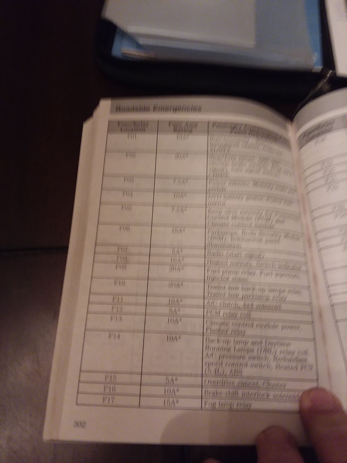

Old Feb 15, 2020 | 05:39 AM
John89's Avatar
John89
Joined: Jul 2017
Posts: 1,448
Likes: 163
From: East Texas
This is from my 08 4.6
Hopefully these aren't too fuzzy.
Good luck getting it figured out
