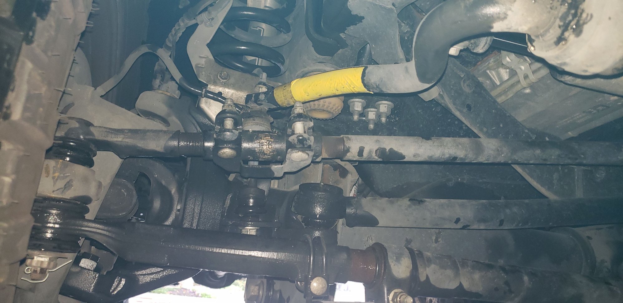

Originally Posted by TX Crawler
The more I think about this, it may be the drag link adjustment sleeve hitting the sway bar. I had issues with this when I 1st did my lift. A good way to check this is put a piece of duct tape on the bottom of the sway bar, drive it around, specifically turning left while pulling into a driveway, etc. If they're contacting each other, the tape will be torn.
That's a great idea, I will try it when this flood is over with.
I snapped a pic for reference. Mine is clocked to just barely clear it now.
