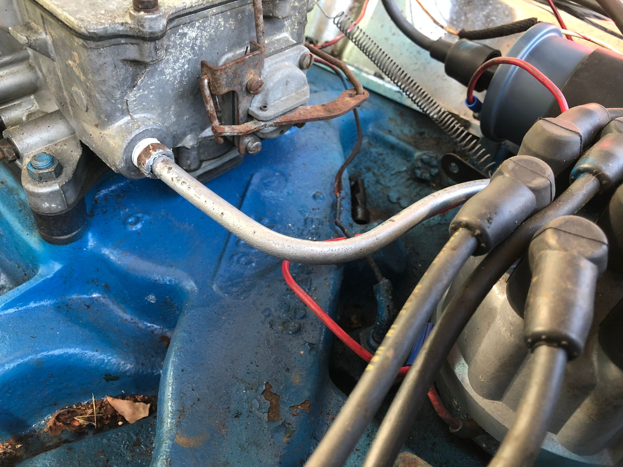

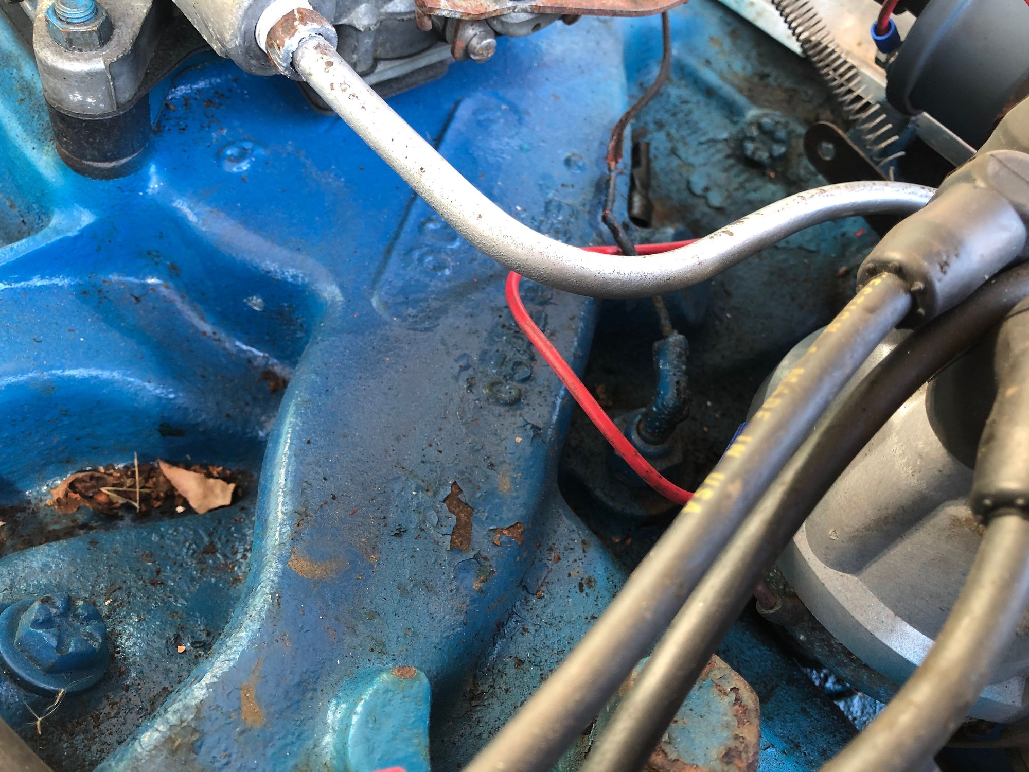

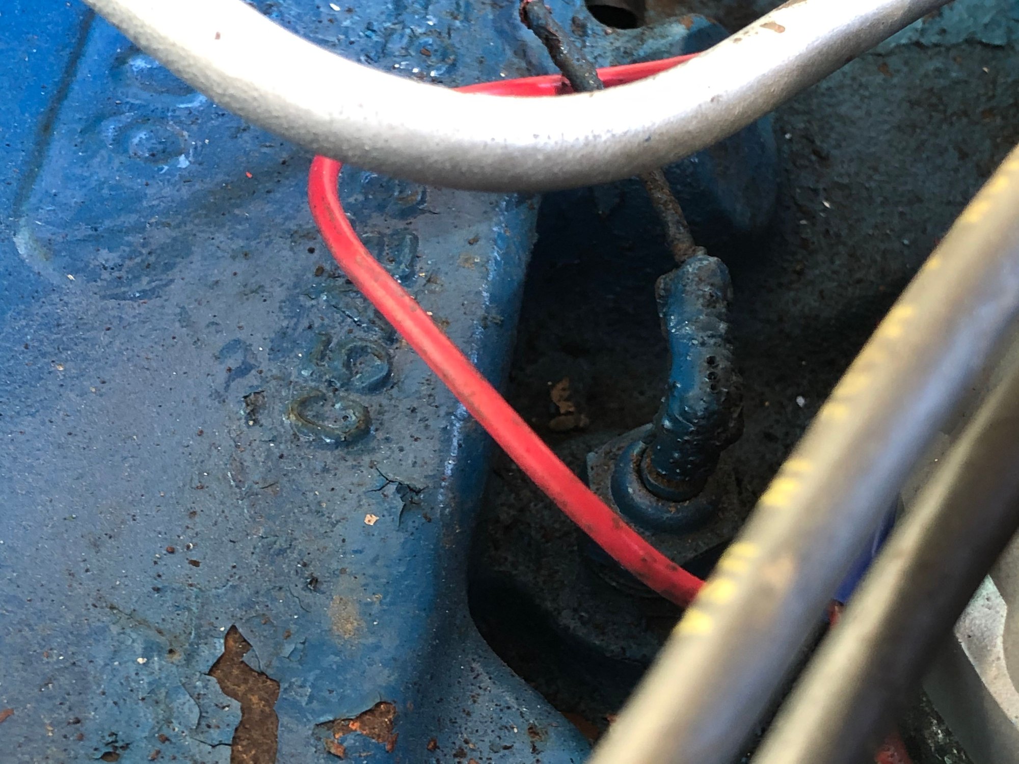

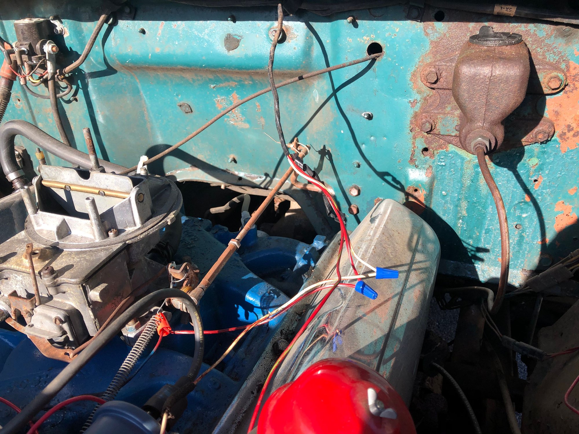

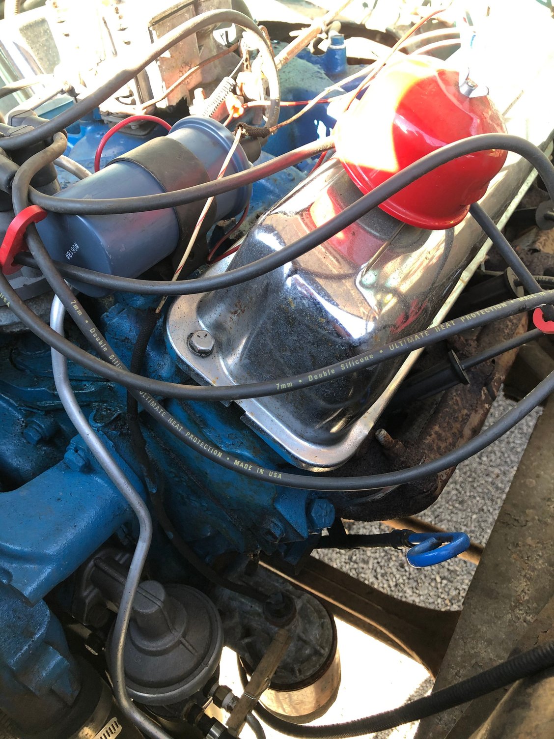

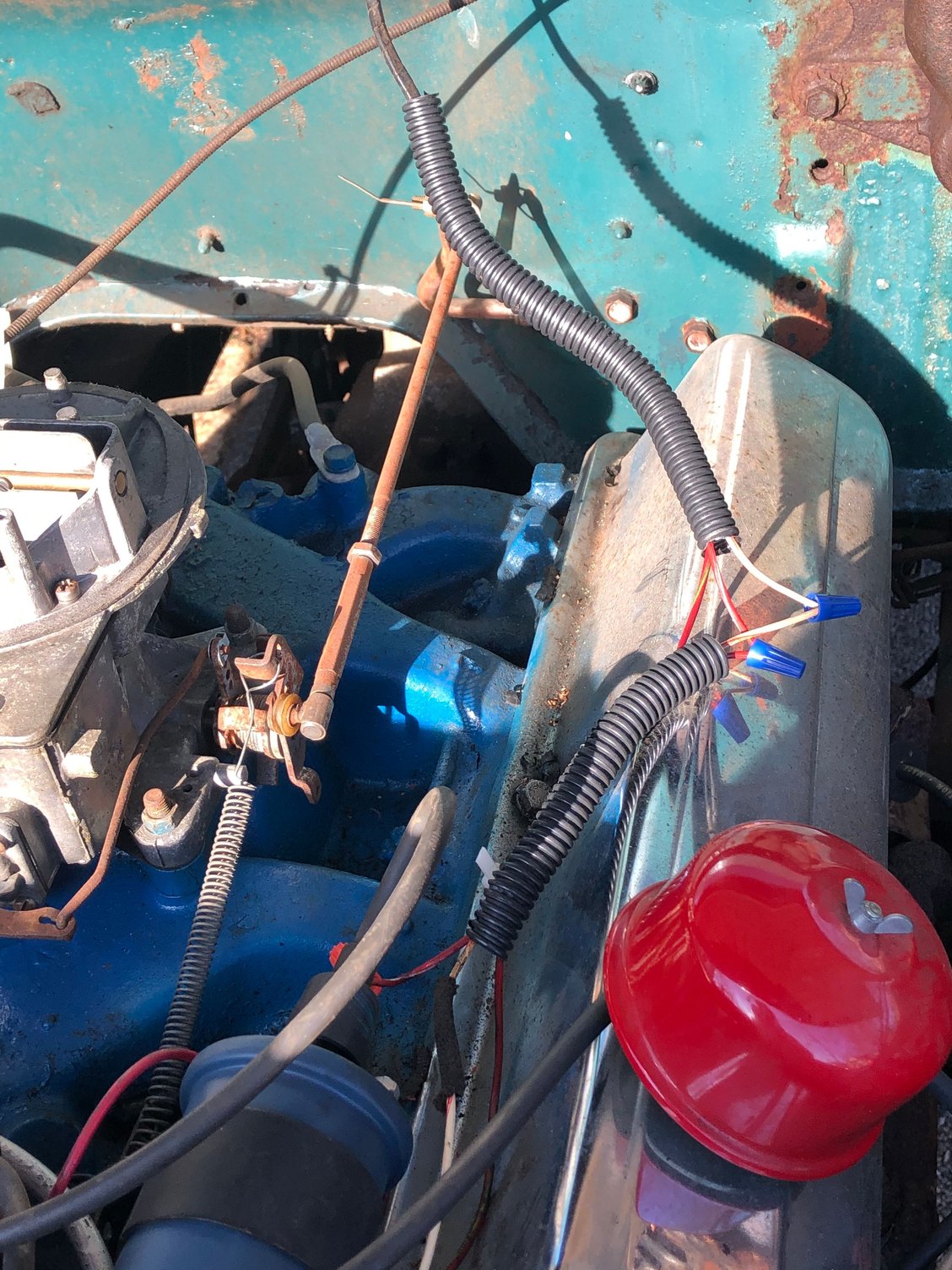

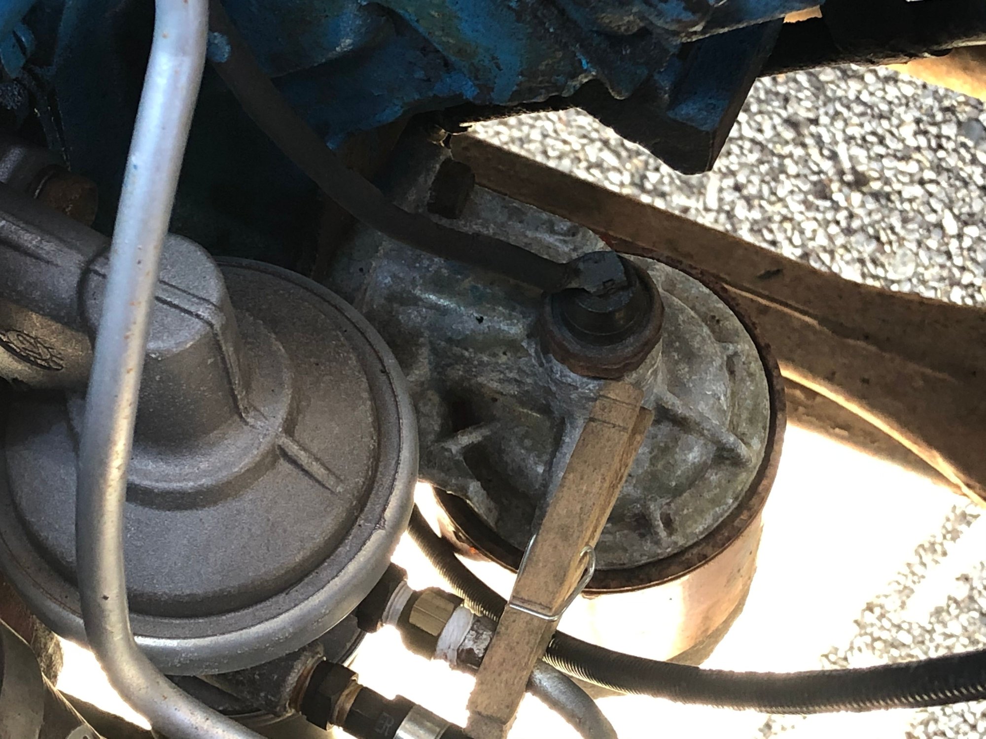

Good afternoon folks. It’s been a while since my baby was running. I checked it out a few times with no luck. I changed out the coil and condenser in the distributor and still no luck. I had three different buddies that were supposed to come look at it with me and they all bailed on me. So today my wife and I went out and started fooling with it for a bit. I checked the power going to the + on the coil. Then pulled the cap and had spark at the points. Not sure if the cap was sparking though. As I was about to give up I saw two of the three wires were cracked and corroded. For likes I cut them, spliced them, and wire nutted them. Wife turned the key and she fired right up. Really made no sense to me. One wire was white with red stripe and went to the oil filter. The other wire was red with a white stripe and went to a terminal on the block. I was thinking that was a temperature sensor. So can some explain to me what this does? Are they a safety switch?

The oil pressure switch and temp switch have nothing to do with the spark. The engine sat for a while so one possibility is that something that was over heating cooled off. That is a failure mode of canister type coils if the oil has boiled off. Keep looking for the real cause.

Check the wiring going to the coil, maybe you have a loose connection or wire going bad. You may have wiggled it while working on the other wires a got it working.

Yeah. Can’t figure it out. I had spark to the points before I could get it started so I’m assuming I had spark to the rotor to right?
