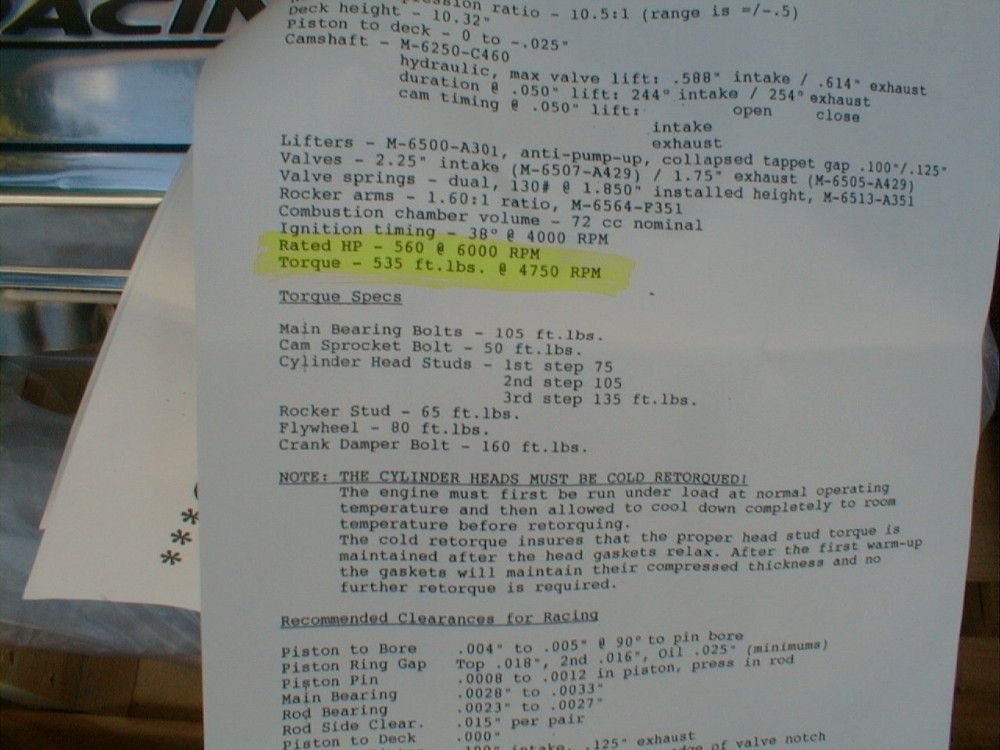

FOR THE HATERS, I'll bite. For starters, a 600 horsepower 460 is not entry level for any street driven truck/car, more like off the charts. Is the 460 capable of big numbers? of course, in an all out race application and with very deep pockets. Regardless, using the 460 for engine swaps has ran it's course. If it's to make your already choked dent run a lil better then yes, a mildly built 460 would surely exceed the 1973-1979's HP rating of 212 in these trucks and would be cheaper than anything else ford has made to include the 351W. If you think on any level it compares to present day that would be a mistake. I have a .040 over 460 from Ford Racing that I purchased new in 2005 for $5887 from Summit when Ford still offered them. As you can see, It's advertised as 560 HP at 6000. This would definitely qualify at "seriously built" not mildly built" You'll note in the spec sheet that it has .588 intake and .614 exhaust so a big ol' bump stick, Cobra Jet heads and a Victor JR high rise with an 850 Holley Brawler DP. I have changed the camshaft which is now .611 and .611. Also at 10.5:1 compression it's on the edge of running pump gas. The engine dyno'd at 520HP before going into the car so that 560 was a lil stretch. This engine is in my Cobra replica and I can say it is not a street friendly engine at any level. Fun? Hell yes but one could never use this for anything other than tearing your hair off between stop lights and parking at a car show or out on the open road where you can leave it at 70-80MPH and get it off of the carburetor idle circuit. It literally drinks gas and idles like it's gonna punch you in the face. I absolutely love the engine or I wouldn't have put it in my car. Godzilla, at least from the spec sheet can't be compared with the 460. The price point and drive ability is the killer for the 460. Easily $8500-$10000 for 600HP and you can't build a carbureted (as you frown on EFI) 460 with 600 civil crank horsepower. Compression on a 460 required to hit 600 at the crank would most likely require race gas. Could you drive it on the street? Not far. Would you tow with it? Not far. Would you drive it to work for the week? You'd be broke. On the front sheet of the spec sheet, Ford themselves say it's an excellent engine for bracket racing!
Ford has given those of us another option to keep a Ford in a Ford. Like Chevy has done with the LS platform. Don't be hatin'
