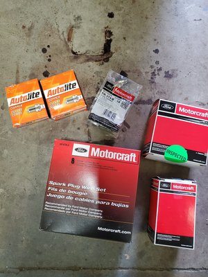

Yep. I just did the same on mine a week ago. Autolites with Motorcraft cap, rotor, wires and coil. It idles so much smoother now!
It was definitely time!
