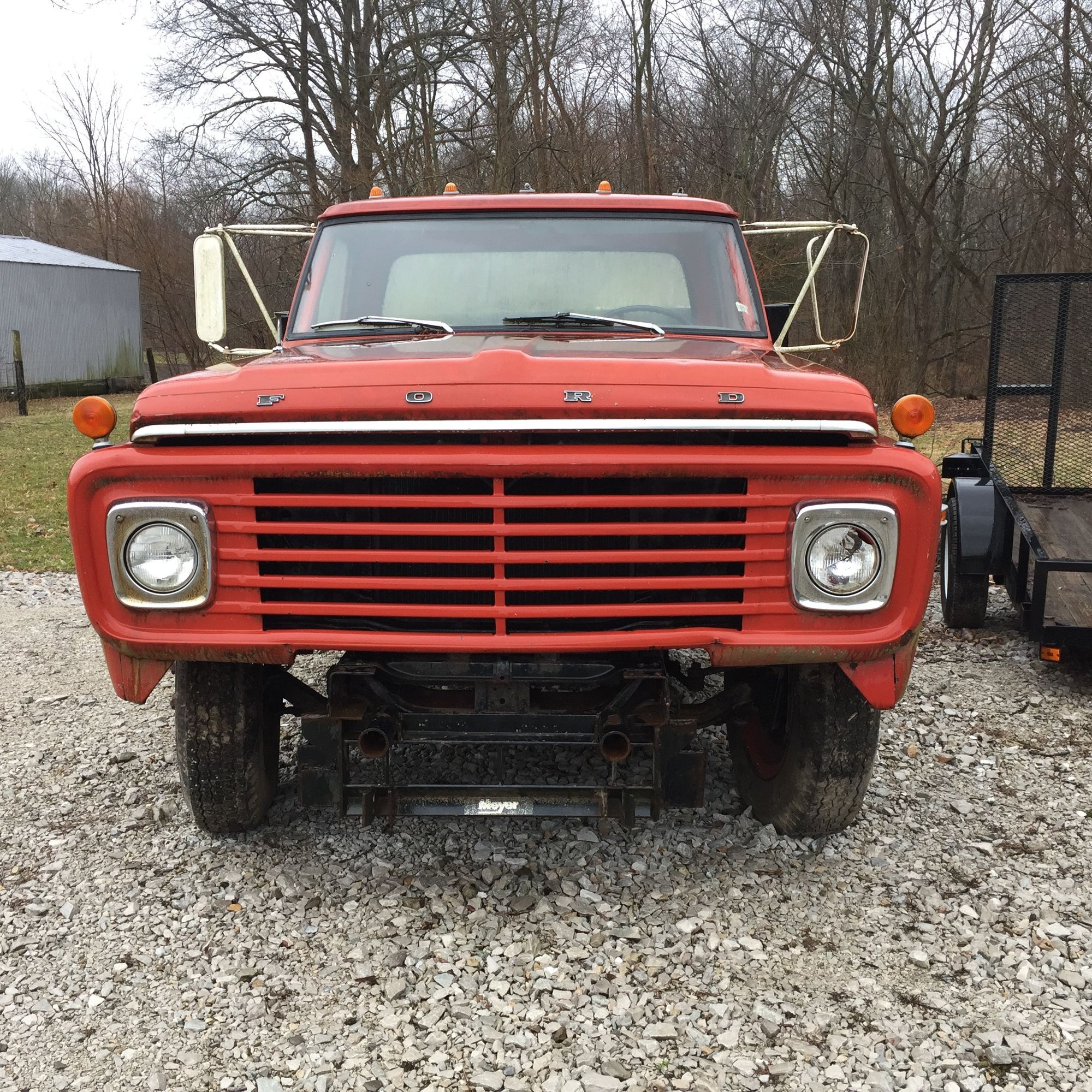

Hi there,
New to the forum. Just picked up a 1968 F500 dump truck and need some help making sure what I have. The title says ”F550 Super Duty” but the emblem on the hood says F500 and what I can make out from trying to do searches with the vin, I think it is a F500. I found your forum and was hoping you can help. The previous owner said it sat for 5 plus years when I got there to look at it. I hooked up the starter , threw a battery in it, filed the points and put some gas down the carb and she fired right up. I want to really go through this and get it on the road but I need to know what I’m working with. I plan on changing all fluids, plugs, etc and fixing the brakes.It has a in line 6 cylinder with a manual tranny. I plan on using this to haul wood for my outdoor furnace. Here’s the VIN:
1st line F50BCD50854
2nd line. 156 M F500 4381 A 42
3rd line. 15000 139 3600 46

FIRST LINE
F50 is the Truck Series code: where F is Conventional 2 axle gas and 50 is the first two numbers of the truck series:500
B is the Engine code: 6 cylinder 300-1V
C is the assembly plant code: Ontario
The rest of the top of the Warranty Plate are the Consecutive Unit numbers: D50854, Made in June
SECOND SECTION
156 is the wheel base
M is the exterior paint code (since your plate is red, this truck was painted) but M is white
F500 is the Model Code, so F500 it is
4381 is the trim and cab or body type: Black interior
A is transmission code: 4-speed New Process 435
42 Real Axle code: Rockwell D-100 ratio is 6.2 and capacity is 13,000 pounds
THIRD SECTION:
15,000 is the recommended max. gross vehicle weight
139 is your certified net horsepower
3600 means at this specified RPM
46 is the Special Order code/ no info on this for you.
Have fun and best of luck!

Hi Jim,
Thanks for all the great info! That will give me a starting point for getting parts for a tuneup. I still have to go through the brakes and find what I might need for that as well. The title says F550 on it, should I have that changed to F500 when I get the title work done? Thanks agin, Brian

I wouldn’t change the title
Unless you feel strongly about this I would not change the Title

Okay, Was there a F550 model? I finally got all my parts together to do a tuneup tomorrow and after that I’ll dive into the brakes and see what I need there. I’d like to have this on the road before spring.

No f550 in '68. "Super Duty" in '68 meant an F800 and larger truck. Imo get the terms on the title corrected.

Thanks for the info. I think I’ll do that. Got to get it safe to be on the road first. Thanks again

Originally Posted by 68FordDT
F50 = F500 (gas).
B = 300 1V I-6.
C = Oakville Ontario Canada Truck Assembly Plant.
D50854 = 1968.
156" Wheelbase.
M = Wimbledon White.
F500 (gas), 15,000 lbs. GVWR
4381: 43 = Charcoal Black Crush Vinyl & Charcoal Black Ladder Pattern Vinyl // 81 = 81A Standard Cab.
A = New Process 435 4 Speed Manual Transmission.
42 = Timken model D100 Single Speed Rear Axle // 6.20-1 / 13,000 lbs. Rear Axle Capacity.
15,000 lbs. Gross Vehicle Weight Rating.
139 net HP @ 3,600 RPM
46 = Indianapolis IN Ford District Sales Office, where the original selling dealer ordered the truck from.
Please ask further questions in the LARGE TRUCK forum, most members of this forum have pickups.
