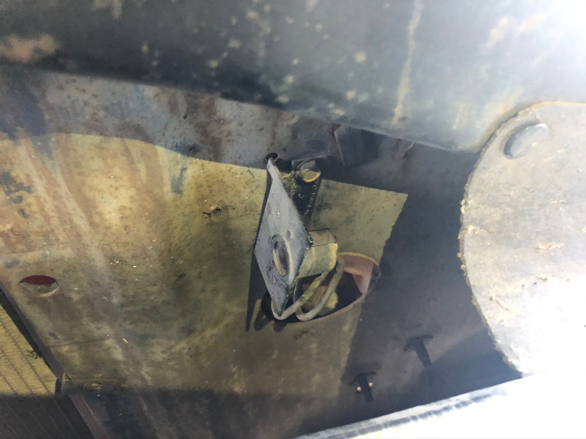

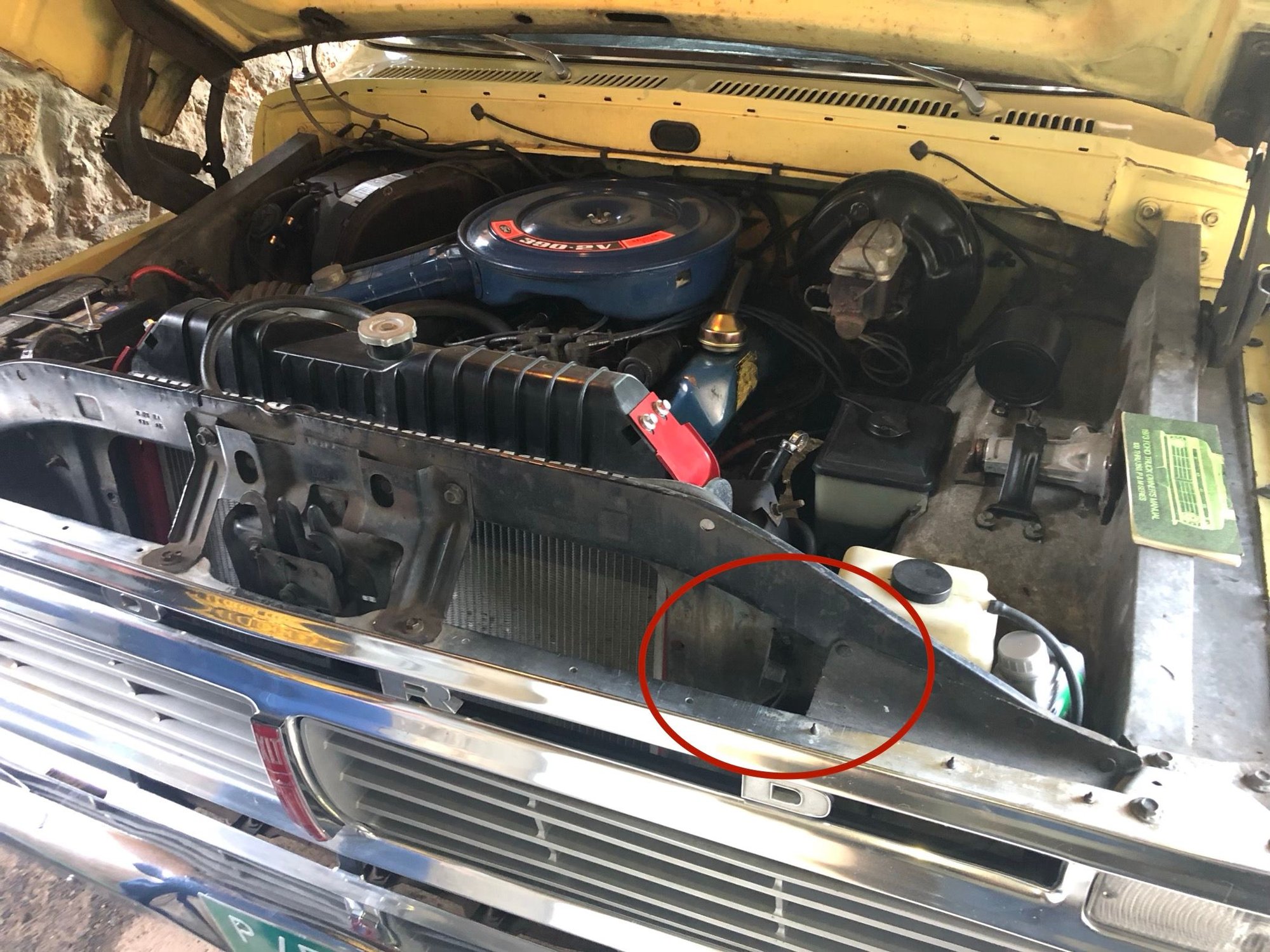

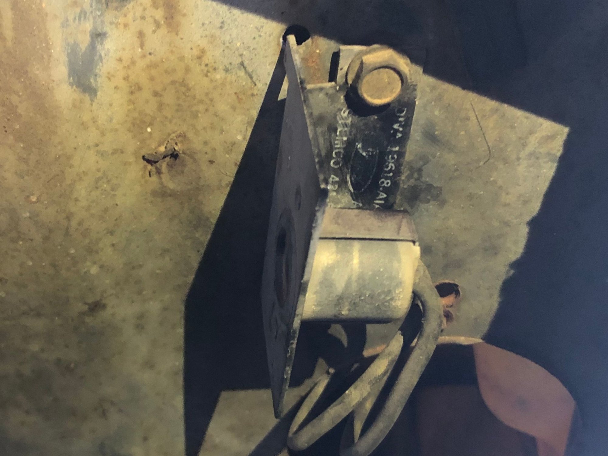

My ‘73 F100 with a 390 has a sensor attached to the radiator support on the driver side. The engineering number on it is D1AV-19518-A1A. Googling that number indicates that it may be a sensor for the EGR system. Does anybody know for sure?
Thank you for your help,
Josep

Can you post some pictures of the sensor and location?

You have (or had) factory A/C. That's part of the A/C system. It's an ambient temp sensor. Later systems didn't use it.
From the MPC:
Thermostat assy., Air conditioner evaporator temperature control
Fits: 73-74 F100-350 w/ integral A/C, located in front of condenser core
P/N D0VY-19618-A Motorcraft P/N YH-121

Yes, the truck originally had factory A/C. The compressor and condenser are missing now but still have the evaporator, brackets, etc..
thanks for the info.!
josep
