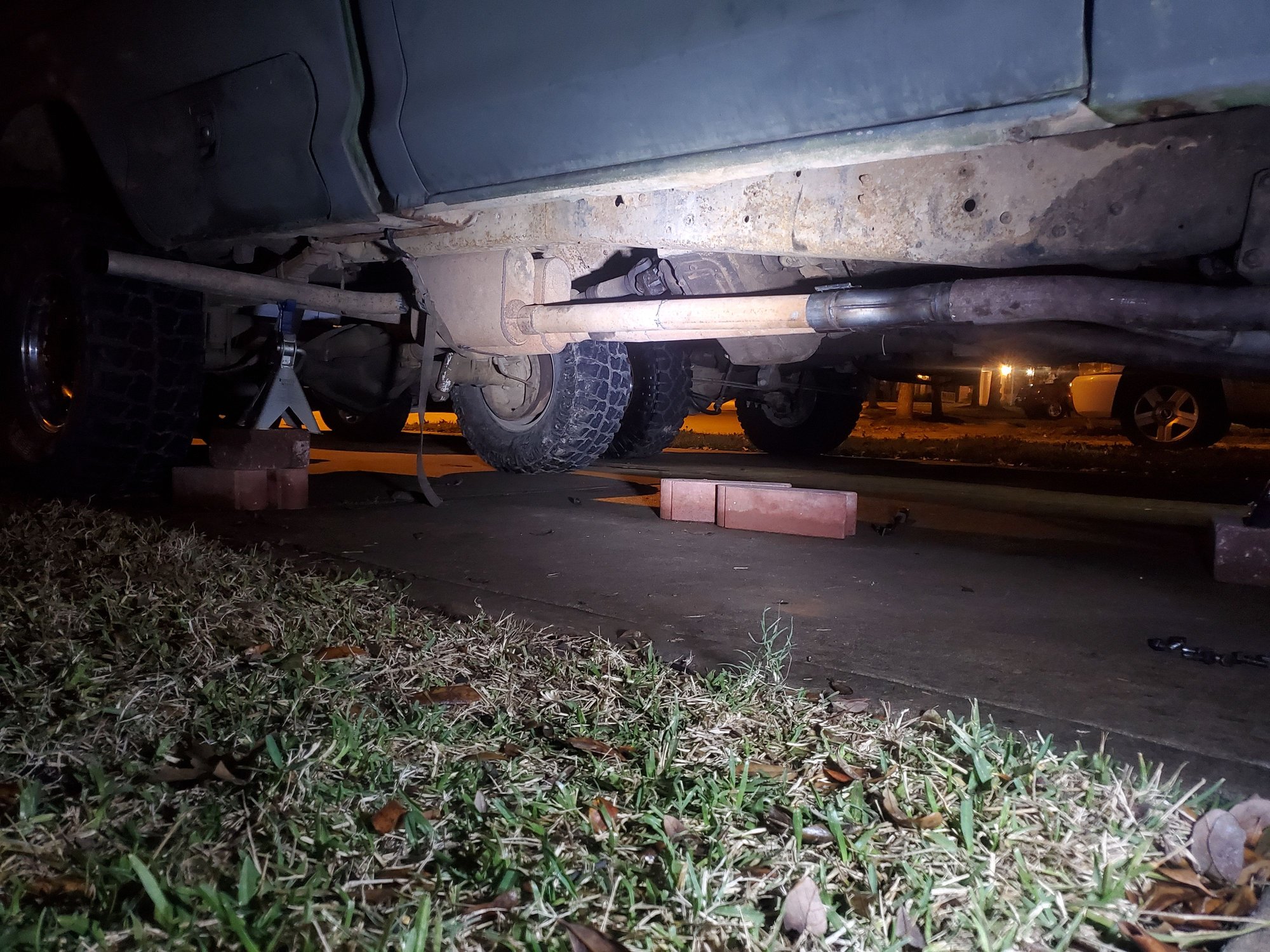

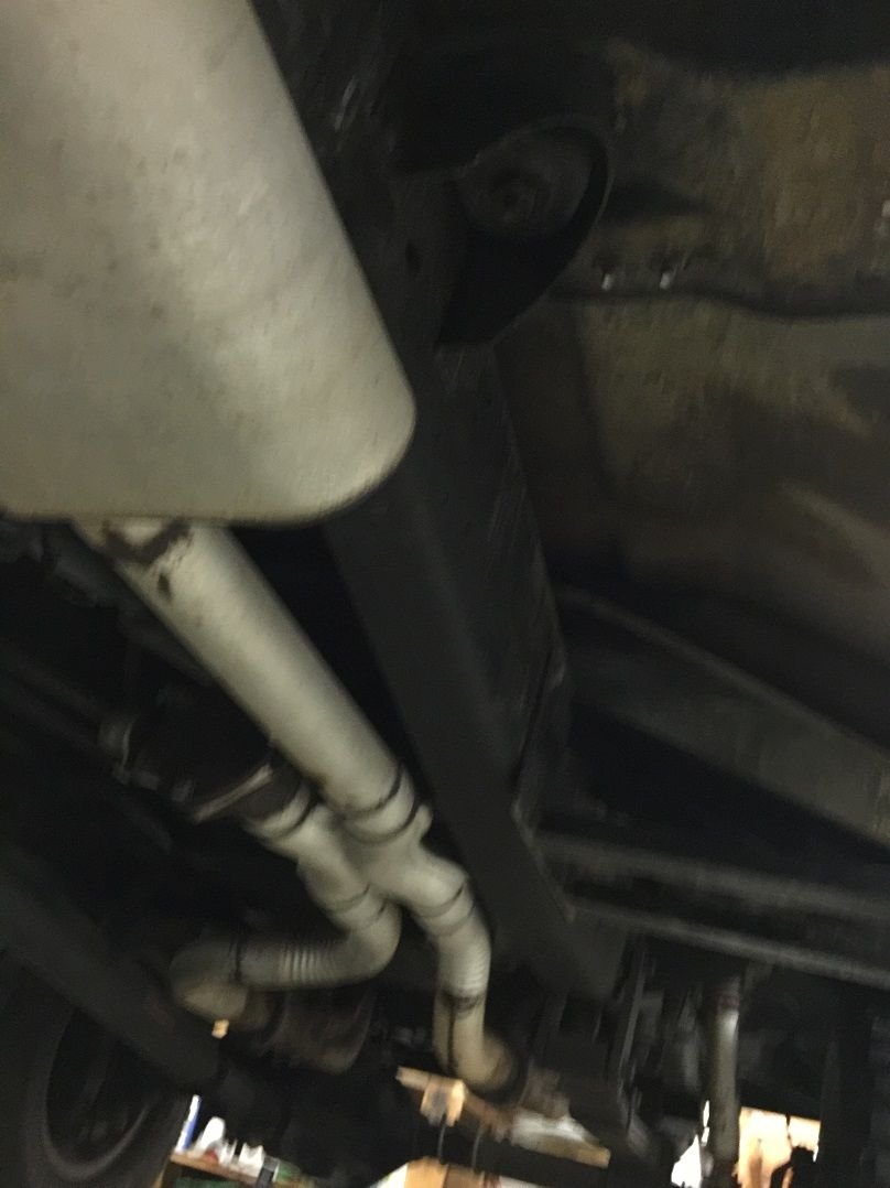

I just did the exhaust on my truck. Design was dictated by what I had laying around in the garage along with what came off the truck to begin with.
Here are a couple pictures:
I have about an inch of clearance from everything besides the crossmember at the front of the trans. I'm closer due to the headers spitting out just below the crossmember.
Hit me up if you have questions. I can take a video of sound if you want... but we all know how accurate the sounds are in those videos...
