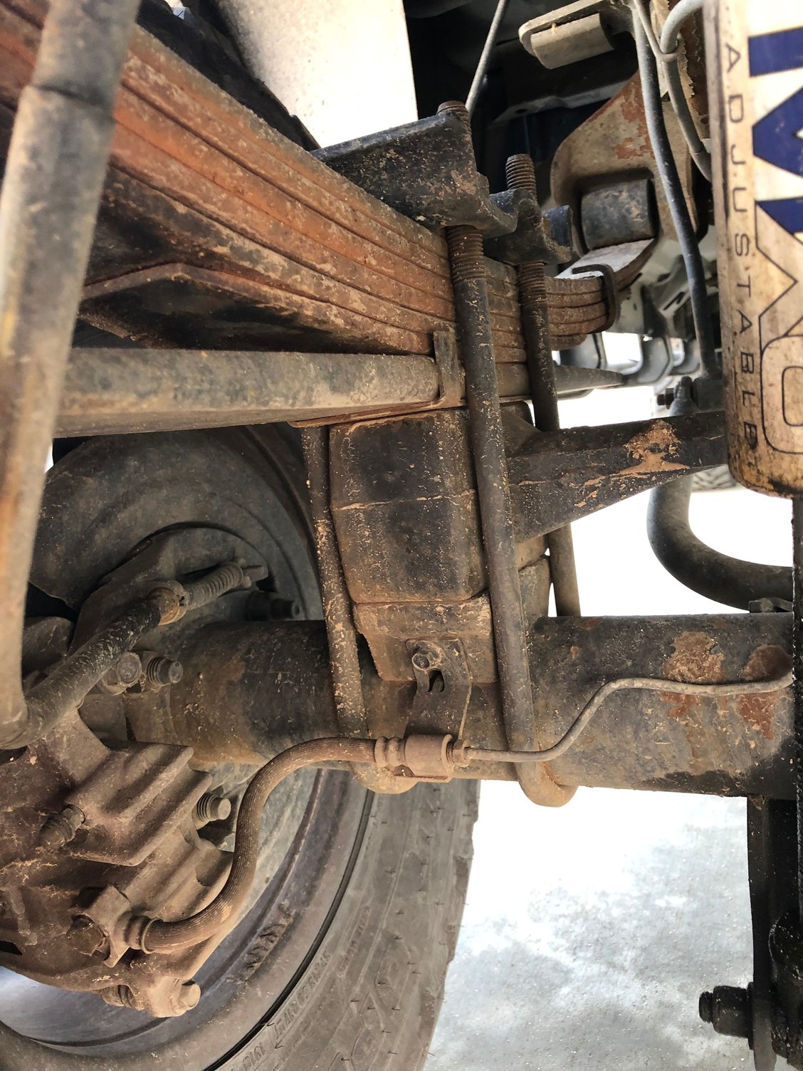

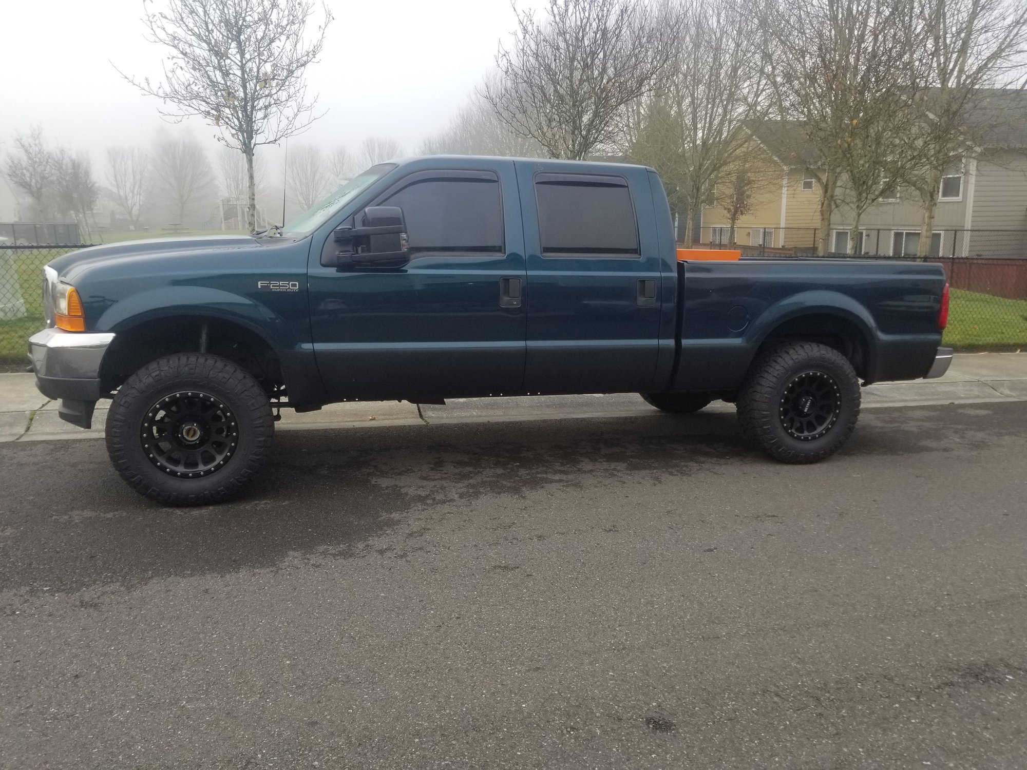

What size tire are you going for?
I have a 99 F250 V10 with 295/70/18's comes out to a 34" tire on mostly stock suspension. ATS X code springs up front and stock for the rest
How big is the rear block on your truck? Looks like a 4" OEM.
New springs up front, modified rears or new and like mentioned before, new shocks, removed spacers potentially brake lines.
