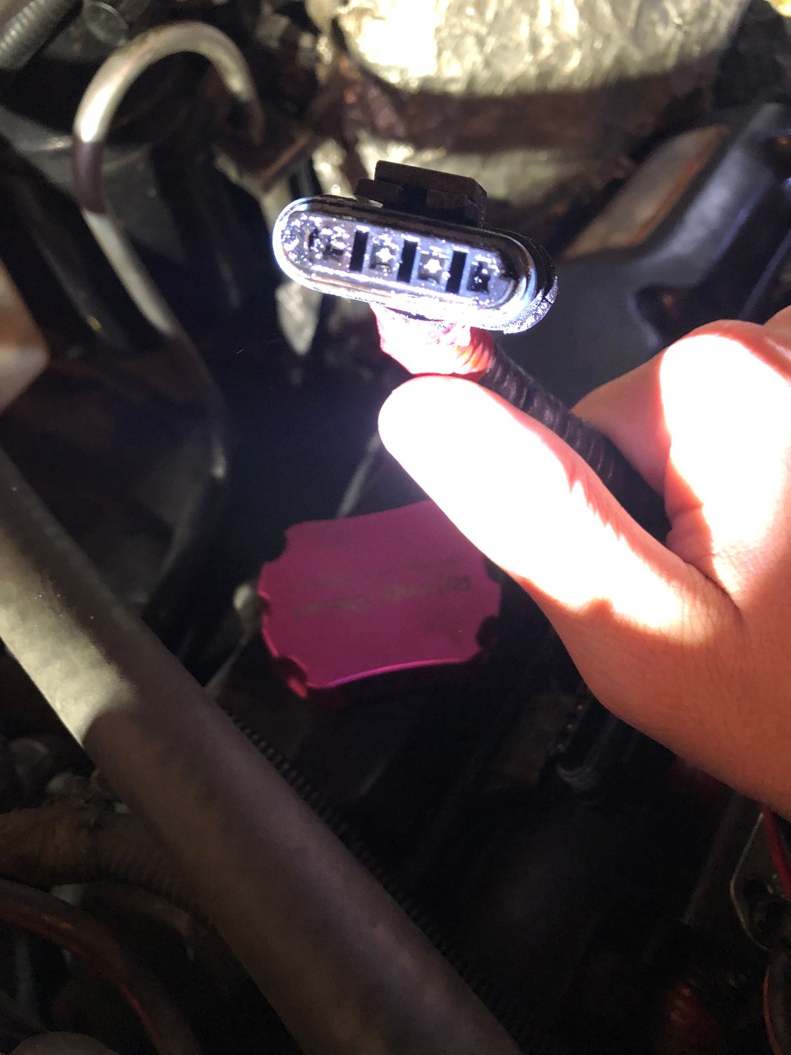

bunch of oil in valve cover harness connections, where is it coming from?
I tried to ohm it only getting .1 on passenger side
Oil inside passenger VCH connection

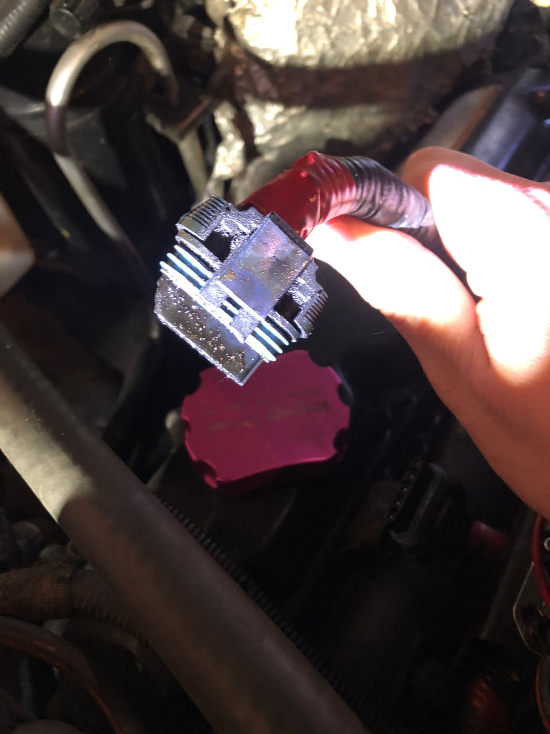

Melted passenger rear. Guess this could be an issue
I cleaned the female side, melted plastic, tried to clean the male side (the wired connector) and the prong broke off., I have a few on order. Will be here tomorrow.
say for instance that glow plug wasn’t getting power, is it enough to make the system not work right and would it still let my truck start rough? It smokes white blue and stinks every startup bad. No cat or muffler.

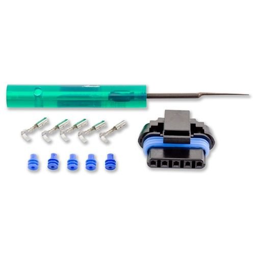

Alliant makes valve cover plugs, I have posted the part number before. I think they sell for about $30/ea. Your covers are going to have to come off, at this point just do new ZD11s and keep receipts for all this stuff in the event you ever have to sell the truck. Cockauto at times has Mahle gaskets, I snatched mine on there. The UVCH I bought new from Riffraff. May as well shim the injectors while in there too, unless yours are fresh. I would do valve springs too.

ZD11s are the Motorcraft glow plugs. The burned plugs you show will cause the smoke, because the glow plugs are not getting juice to heat them. When replacing the pigtail, cut and solder 1 wire at a time. DO NOT use but connectors to splice the wires, as the connections will corrode over time and you will wind up with the same problem. Doing 1 wire at a time will reduce the chance of getting 2 wires crossed.

Here is how I would fix the harness side -
