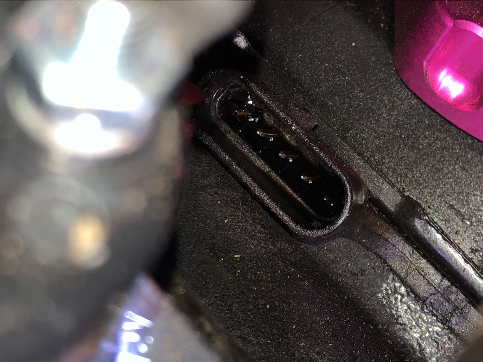

bunch of oil in valve cover harness connections, where is it coming from?
I tried to ohm it only getting .1 on passenger side
Oil inside passenger VCH connection
