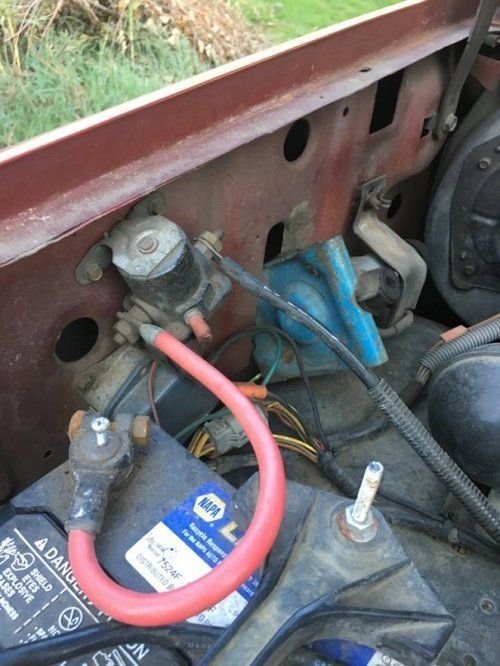

Only about a month later, here's what I finally did to clean up that unsightly positive cable.

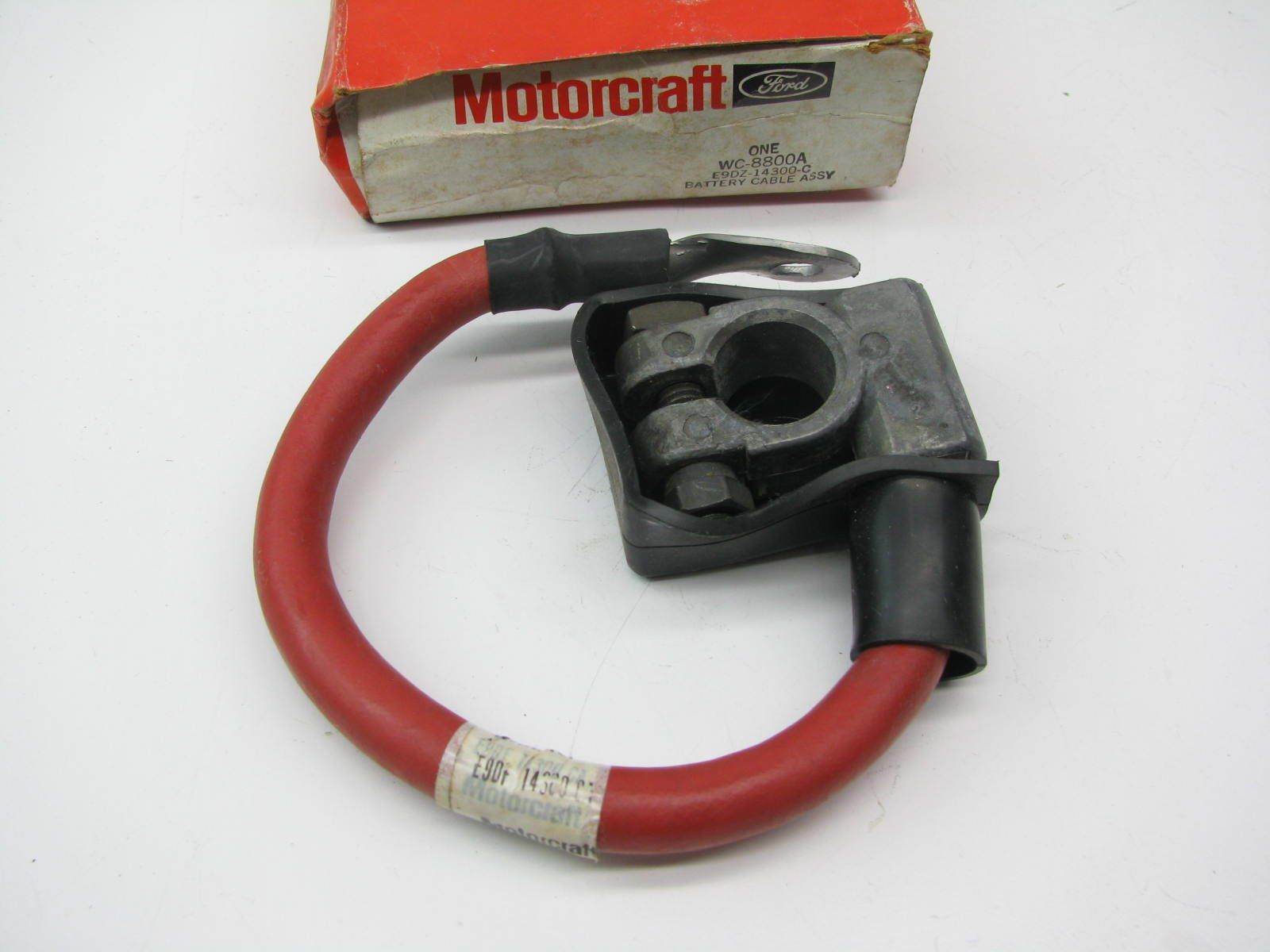

The non-stock positive cable I had:
Not exactly stock, but this cable had the flag terminal I wanted and a cover over the exposed terminal:
Motorcraft WC-8800A
I shortened the cable a little bit and crimped a new 5/16" terminal on the end. I also relocated the starter relay aft about two inches to reduce the curvature of the cable:

Used to be easier back when you could readily find on-the-shelf cables down to 9" long at the parts stores. That's what I've used in the past and they worked well for my other applications (never bought a new cable for the '83).
Nowadays I use the military lug with cables that have two eyelets on them. But I really like the stock flag style too. But also like larger gauge cables, which yours looks like kr. Any indication of what gauge is used?
My '93 has the clean flag style cable (still original) but is longer and smaller at 6ga I believe.
Paul

Agreed. I checked several local stores and all I could find were those el cheapo blister pack cables. Nothing shorter than 12 inches, and all had a 3/8" lug. This really irritated my CDO nature, as the starter relay has 5/16" studs. I couldn't find anything available locally with a flag terminal, either. I specifically wanted that style because the offset helps ease the bend.
It wasn't marked anywhere, but it fit perfectly in a 2 ga terminal.

Cool. That's what it looks like too, but I've never heard of an original equipment Ford battery cable in that size. Maybe it's for a diesel application?
Hmm, looking at it again, I see the number is "E9DZ" I wonder if D means diesel. Seems out of character, but I don't remember ever looking at any other engineering numbers with the letter D instead of the usual A or T.
Pretty stout looking. Should last a long time.
Paul

Post
Paul
The D in the PN PREFIX E9DZ ID's as TAURUS.
The eBay listing indeed showed this part as applicable for the Taurus/Sable. I almost didn't buy it, thinking the wire gauge would be too small. An OEM isn't going to make a cable one strand bigger than needed.
Imagine my surprise when it arrived and was beefier than expected. No idea why Ford used such a stout cable for that application. It's heavier than the stock ground and starter cables on my truck.
There wasn't much flex with this heavy cable. If fabricating one yourself, it may be worthwhile to go slightly smaller for more flexibility.
This picture shows the cross section of the piece I trimmed from the new cable, to the right. On the left is piece of cable from another project, marked as #2 gauge. The cross section of the copper looks the same on both, approximately 5/16" diameter. As previously mentioned, the new cable fit perfectly in a 2 gauge terminal.
