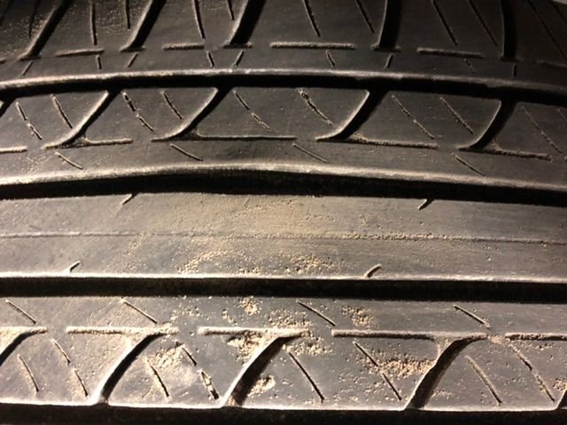

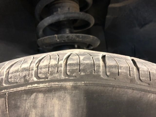

Look and feel for bulges in the tread and sidewalls. They’re not always obvious (see pics below from a slipped belt in my tire that only caused a pull - no vibration or shudder which is typical).
A thorough inspection of the front end should find the source of the clunking for sure. If the steering wander and torque steer aren’t revealed as well, an alignment may be the necessary fix.
