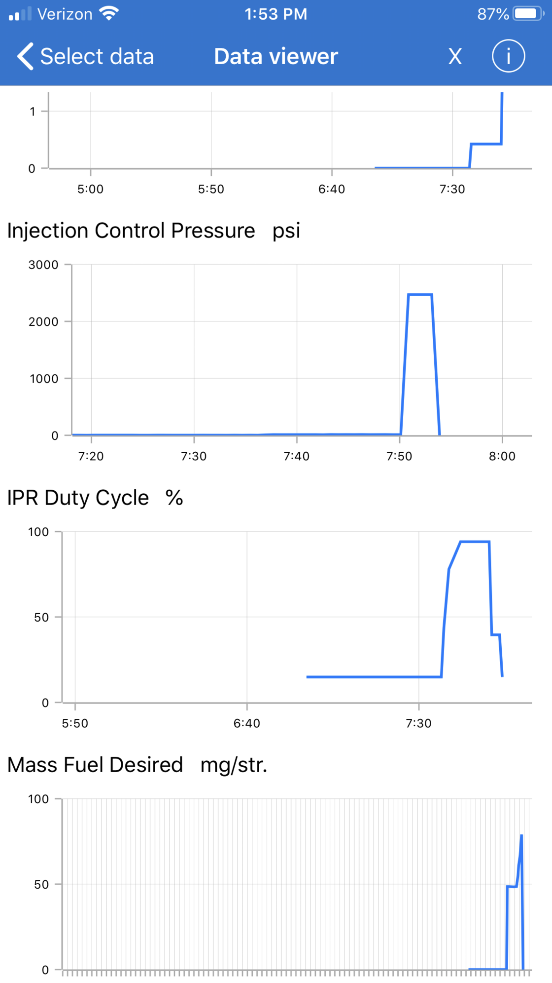

I have to run more tests and I’ll post those codes soon too but my ipr was up around 94 something and when the check engine light came on it instantly dropped to around the 40s so I stopped.

Here are the codes and what some graphs:

since both IPC and IPR show issues intermittent, i am willing to bet you have a harness issue
unwrap and follow it, there are not that many wires in the bowl area
