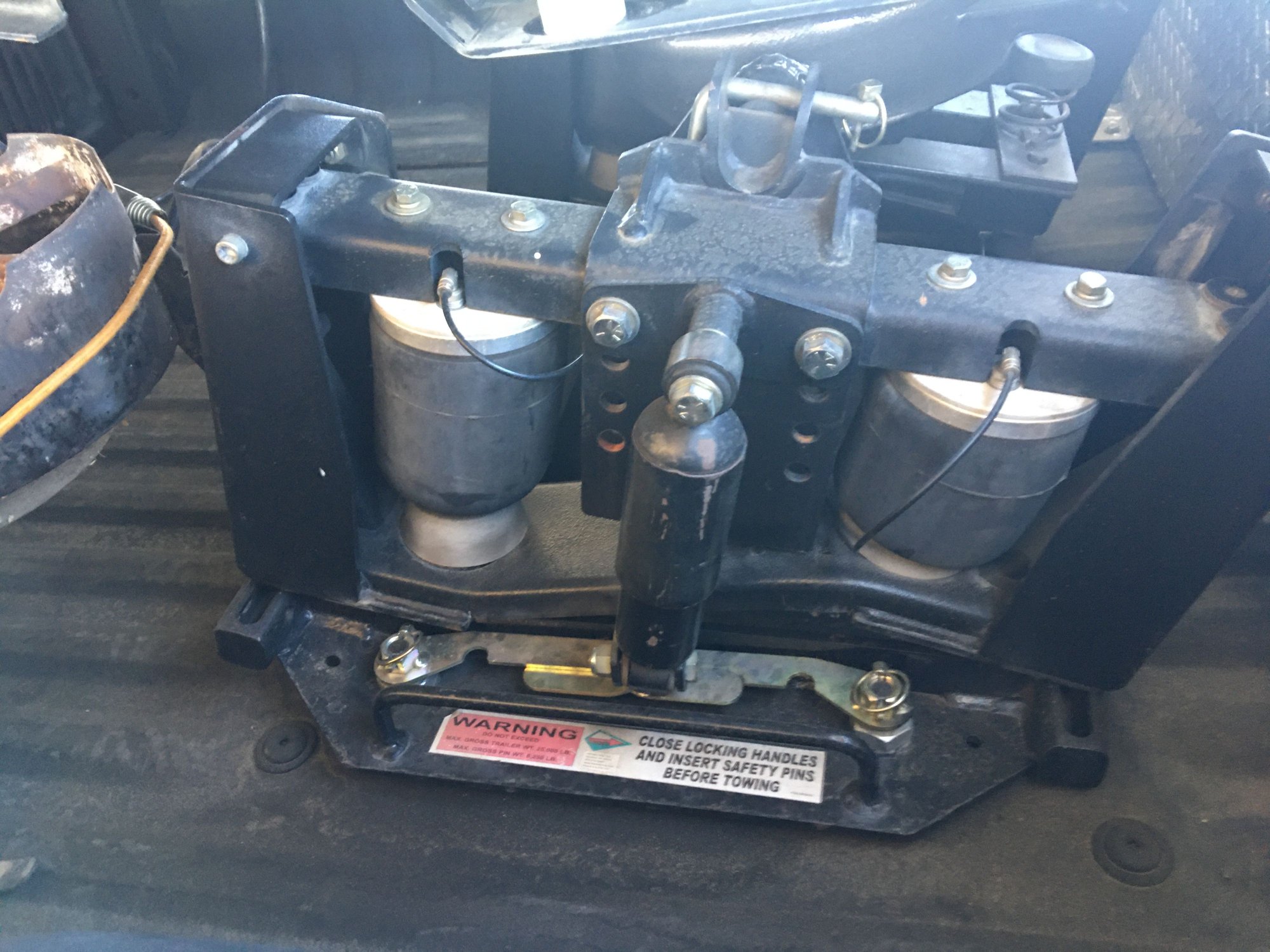

The hitch was an Airsafe 25K sitting on a Hensley adapter to fit the Ford Pucks

Hitch looks robust enough to take the trailer. Appears to me that it is not compromised.
Look again, the plates under the airbags are supposed to be flat not S curved and cracked. The adapter is supposed to be flat on the truck bed. The Ford under bed system was not damaged. I am not an engineer but I think the hitch structure failed because of the adapter, The Ford mounting system is 13" center to center and the adapter to hitch is 29.5" which leaves a lot of unattached area.

Yep, that hitch is toast.

Now I see, not familiar with the hitch. Yeah it is toast.
