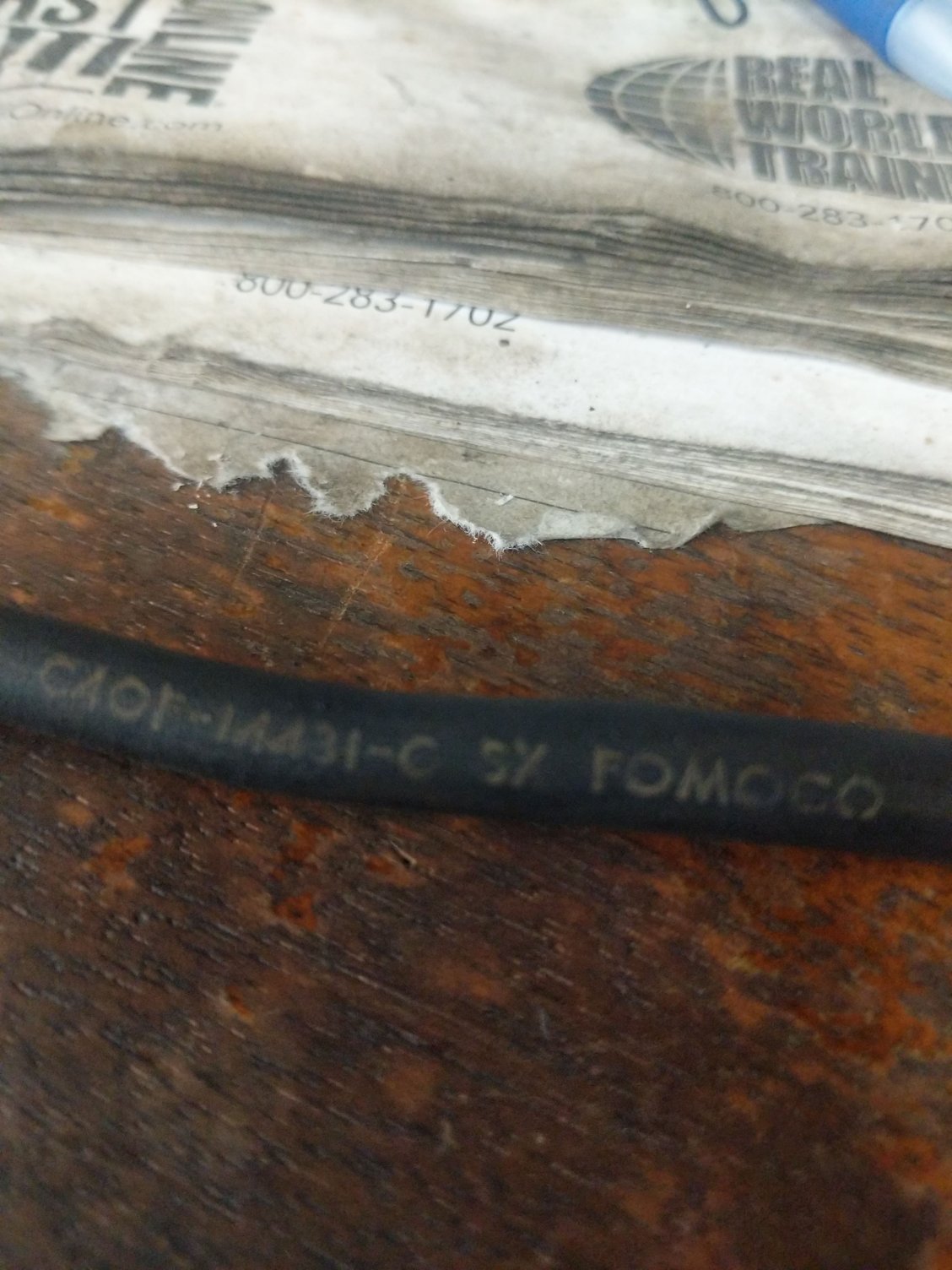

You'll get a kick out of this 6ga relay to starter cable.
FoMoCo C1TF-14431-AC SX
Well look at that.
Yep. Solenoid to the starter. Original 6ga. Headers are hard on that particular wire.
