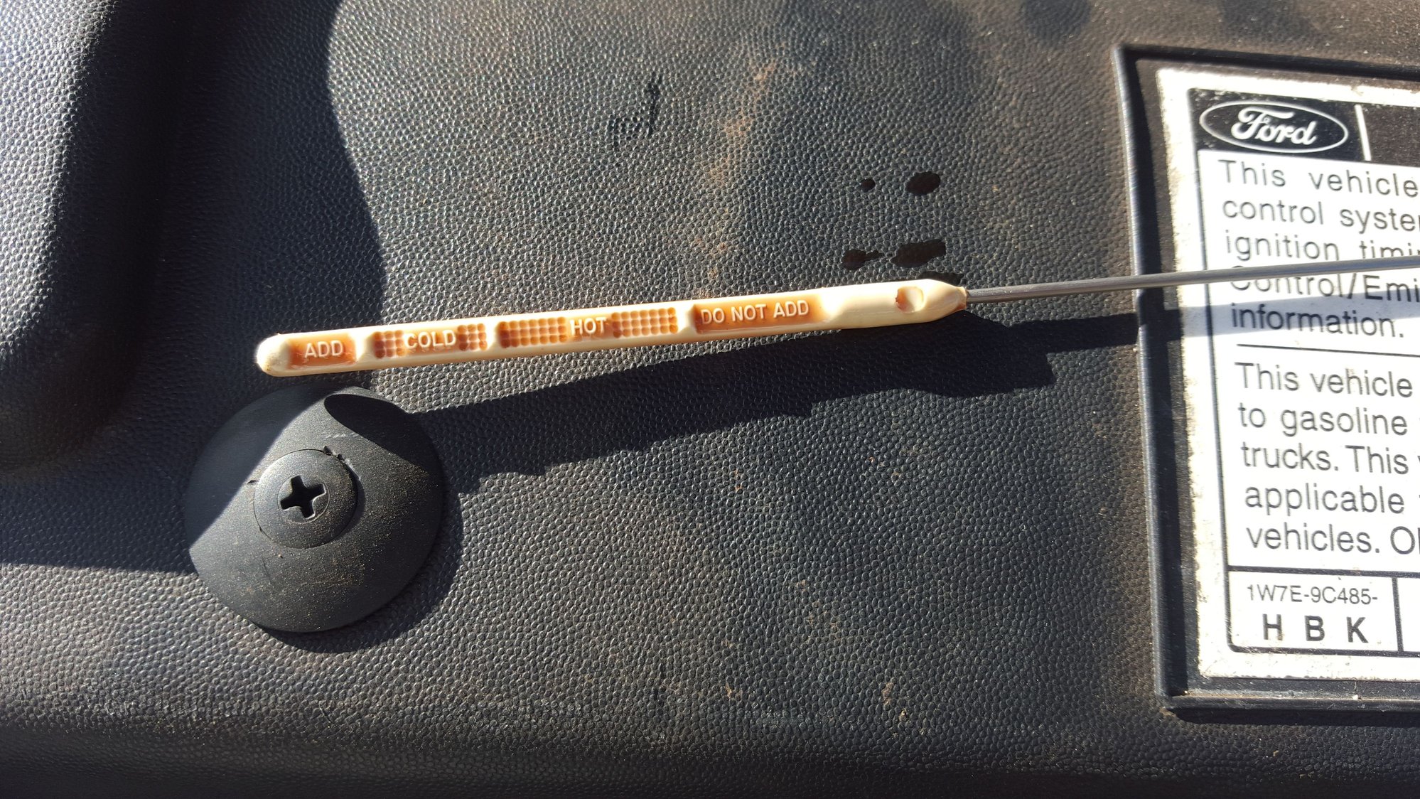

Here's a pic of the dipstick. It's hard to see, but I think the fluid is up onto the steel part a little bit. It's about 1-1/4" above the HOT range.
This is after a 20 minute ride with medium highway traffic; so she's warmed up, idling in park, on level ground.
When I draw some fluid out, I'm gonna check it for coolant/water.
On my previous F-150, the radiator failed and it let a lot of water into the trans. That wound up ruining the trans, so I'm watching this closely.
