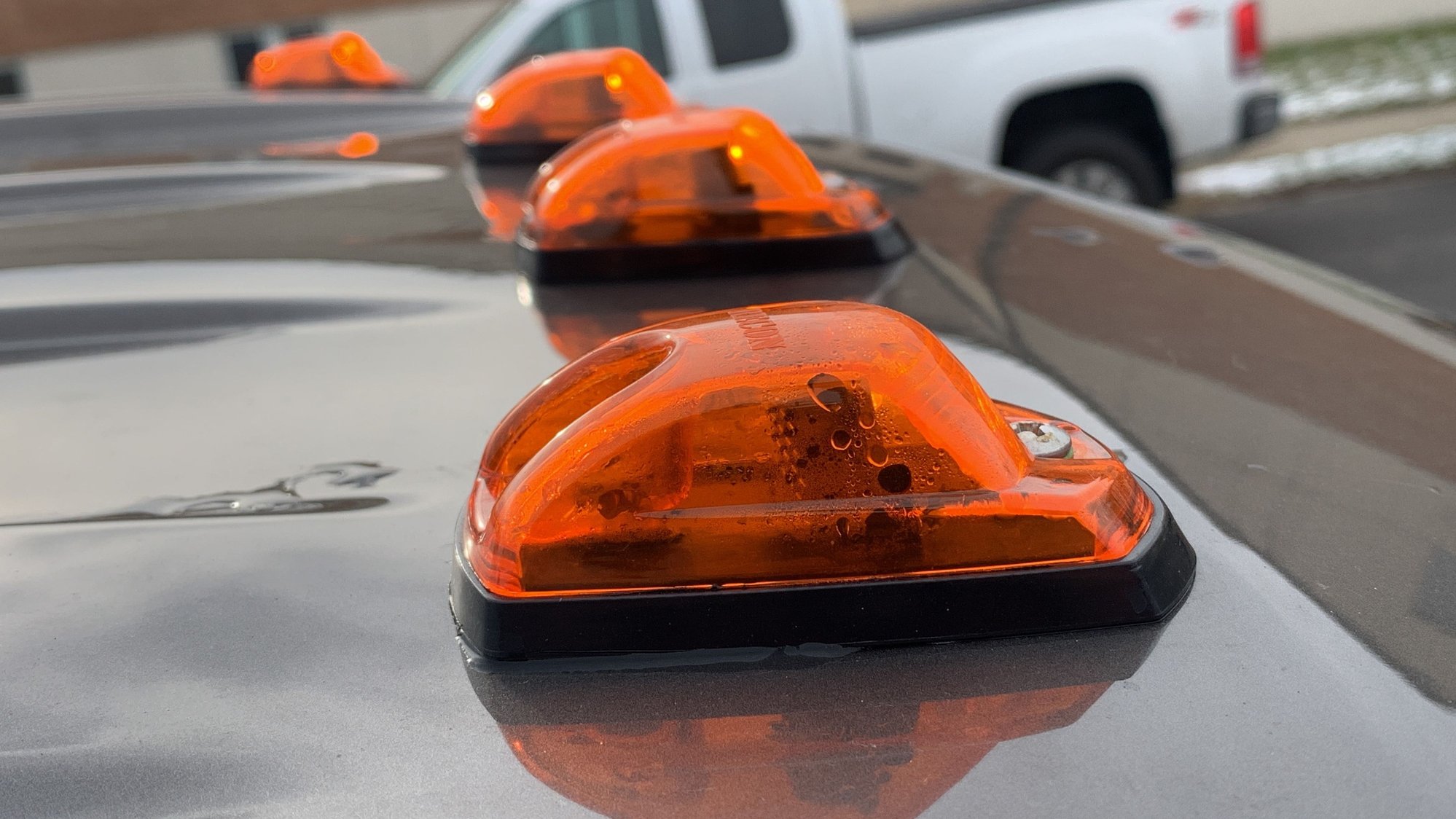

These lights are junk installed them and one blew out and all of them full of moisture. At this point there’s nothing I can do as I drilled my roof . I also put silicone under the light

Why not go buy the OEM lights to replace the Recons?

Uh oh... How long have you had them on?
I do drive through car washes about once a week... will report back if issues arise. I also siliconed the tops of the mounting screws but not sure if that would address the issue that you mentioned. Replacing them would be easy now that they are there. I would rather have them than not.

I had them on for 3 weeks before the one burned out and I noticed the moisture, they are easy to swap out , recon did send me a new set but I’ll see how long these last

I’m not too happy with my Recon clear with orange LED lights that I had professionally installed. 1 of the 5 did not work and Recon provided 2 replacements. While they look great, 3 of the 5 have moisture inside the light housing. I’m going to have to take it back and have it looked at. Unless it is common for moisture to condensate inside the lights? No evidence on water intrusion inside the cab. It looks like a seal issue between the plastic lens cover and the base.
