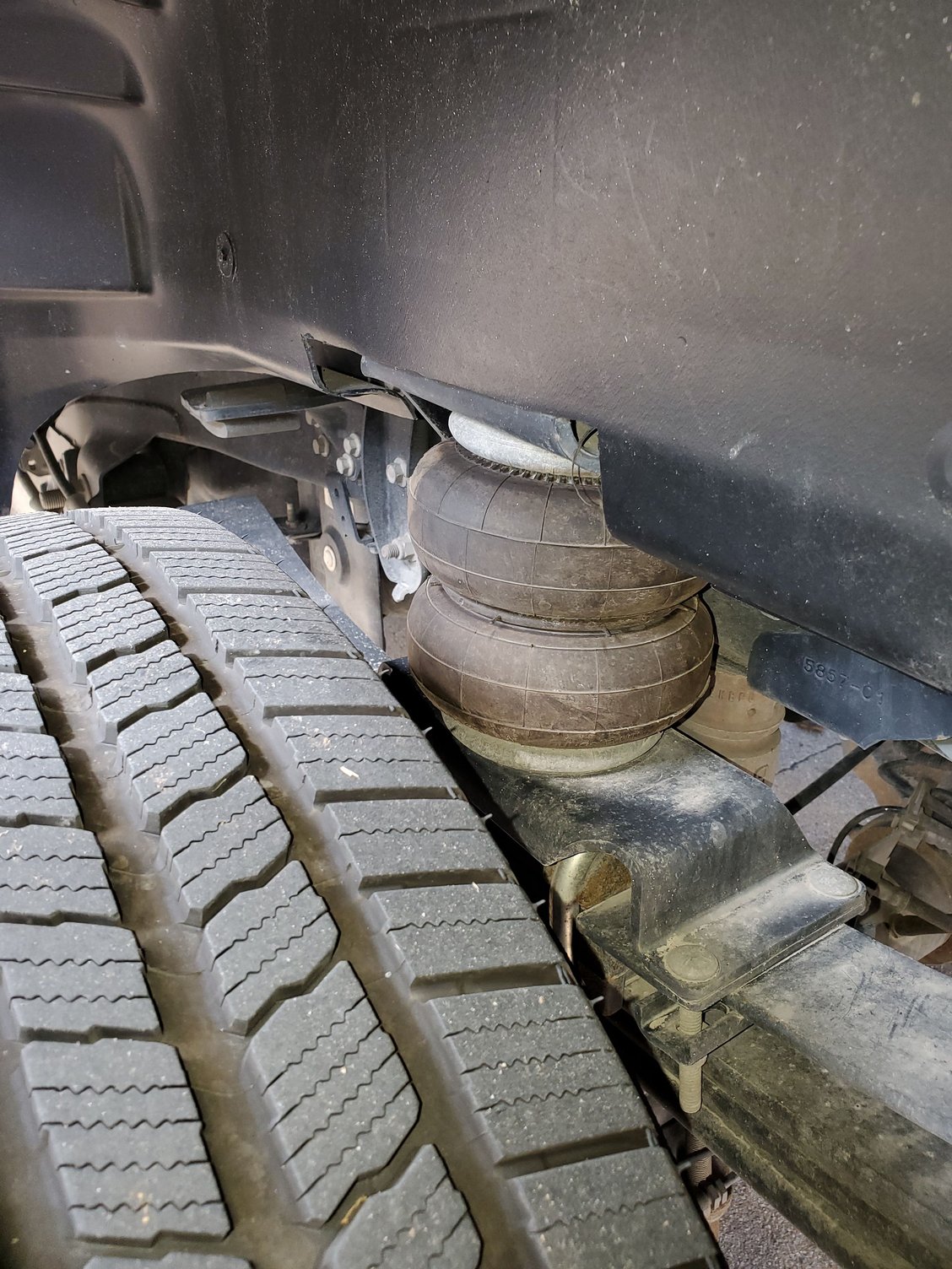

Originally Posted by tomoran
Sooner in TN - I also originally installed the 1.5" PMF blocks with bump stop but without the airbag support. 1000 miles from home I hit a dip in the road and bent the bump stop tang on the PMF block. It's not strong enough to support the airbag. I ended up removing them and going with the PMF blocks with airbag supports.
Any chance you can post a picture of the PMF block w/ airbags on your truck? I"m about to pull the trigger on 1.5" blocks and AirSprings and want to see how the airbag is mounted to PMF's airbag support plate.
Old Jul 21, 2020 | 04:17 PM
tomoran's Avatar
tomoran
Joined: Feb 2018
Posts: 7
Here you go. Let me know if you need anything else. I'm very happy with this setup.
Old Jul 21, 2020 | 04:26 PM
tsmithco's Avatar
tsmithco
Joined: Jun 2020
Posts: 435
Likes: 140
Thanks. Looks like the PMF support isnt just connect to the block, but has a price that sits on the axle?
