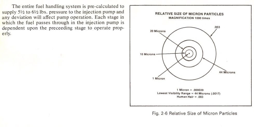

particles larger than 10 Microns will damage the injection pump.... MotorCrap Wix and Fram do not filter down to that level.......Period
Most Diesel fuels at the Pump are filtered to 5 Micron in the USA
