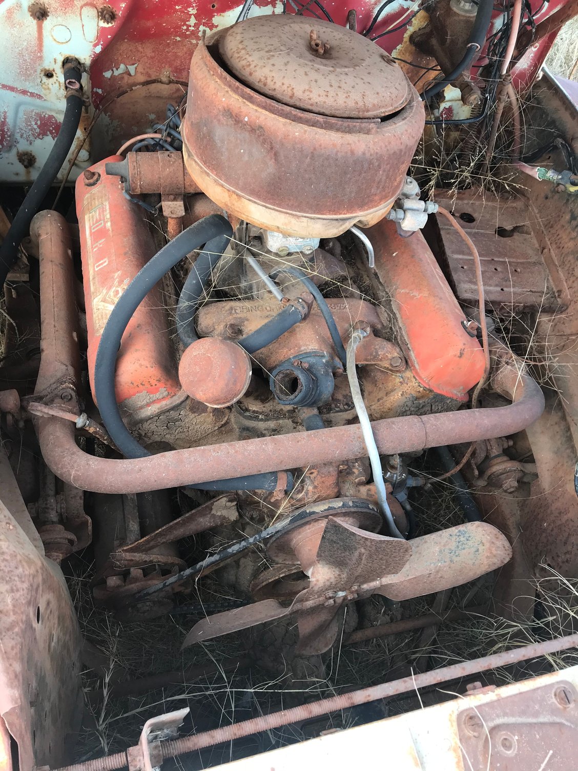

Yep, you have a car Y-block in it.
Here is a link for y-block identification info.TECHNICAL
See if you can locate the casting numbers and let us know.

It’s a 54-55 engine I’d guess. it has freeze plugs in the ends of the heads and 56 and newer don’t. And yes originally from a car, which makes me ask, is this really in a truck? I see independent front suspension that looks like really early ford car 53-58. Just wondering

If that's the engine in the truck, either the truck was modified with car suspension, or the truck itself is sitting on a car frame. Notice the car bumper on the front?

And I don't see a steering wheel either. Baker6688 do you know any of the vehicle's history?
