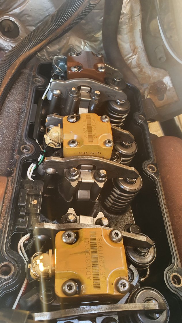

Hey guys. Couldn't find a definitive answer to this question. Im in the middle of doing UVCH and pigtails ... as well as a few other bits (OCR, FRX, riffraff 4x4 wheel just arrived. Cheers Clay 👍 ). Just torqued the injectors down to 125 in/lbs cold. Cant do hot yet as the harnesses aren't finished. They seemed pretty loose to me.
So was wondering if i do the rocker ams whilst there or just leave them be?
Also how do these injectors look? Kinda newish or is the colour of them about normal? I was surprised how yellow they were still apart from #8 which I assume is a diff colour as it's a long lead.

Yes, I would do the rockers too while you are there. The injectors colors are correct for the AD and the AE so no issue there.

Alright cheers . Will do them while I'm at it.
