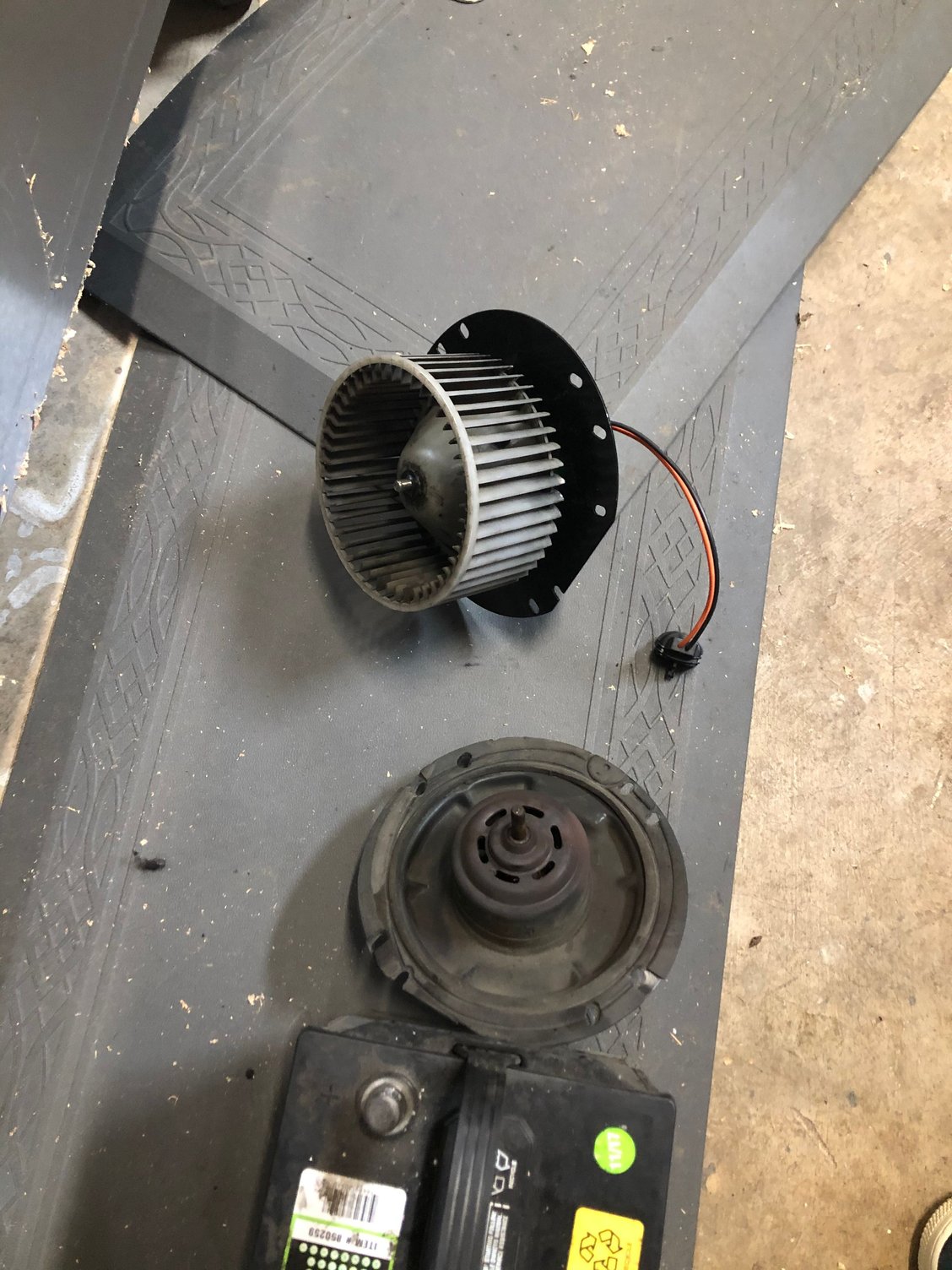

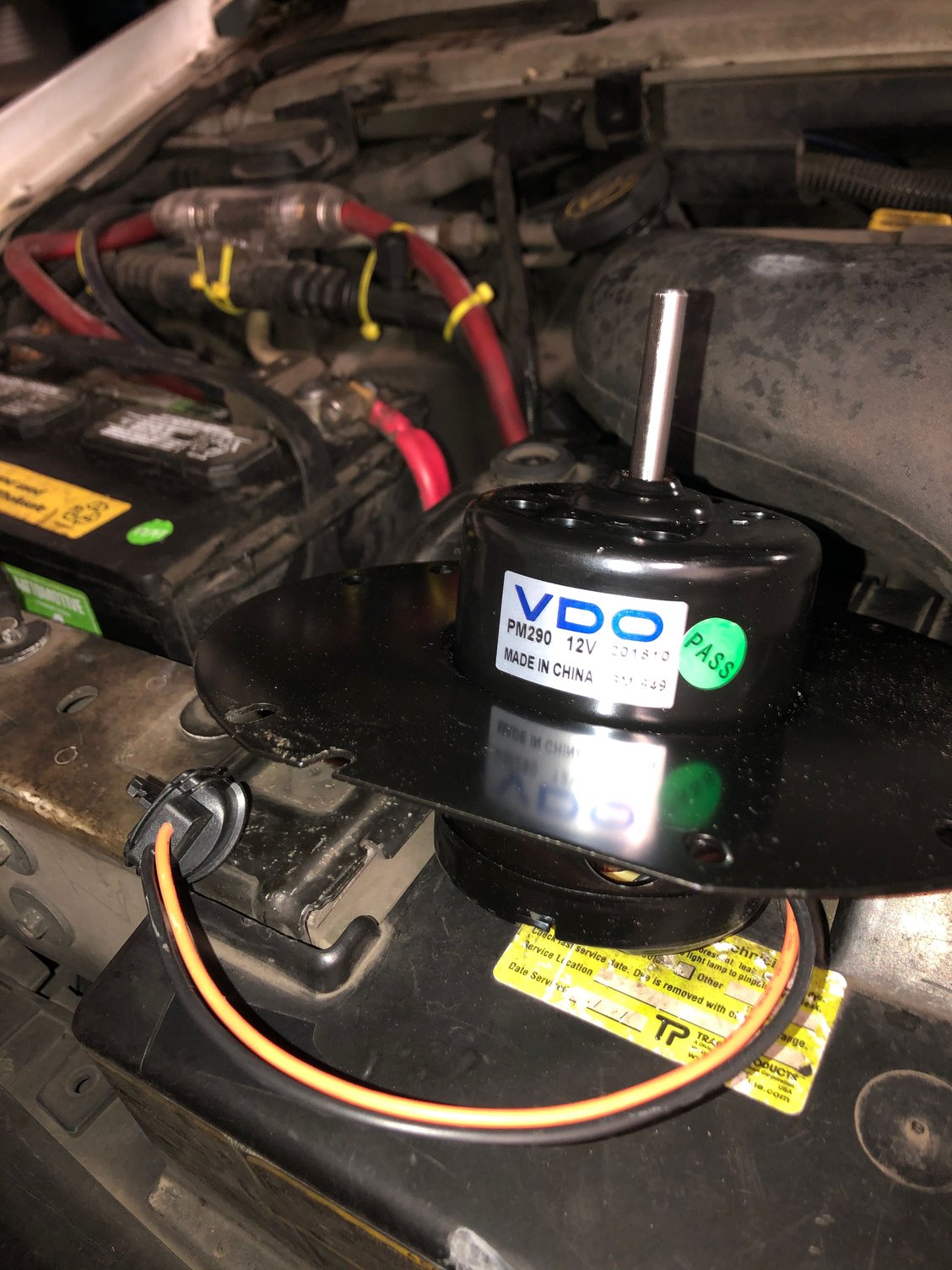

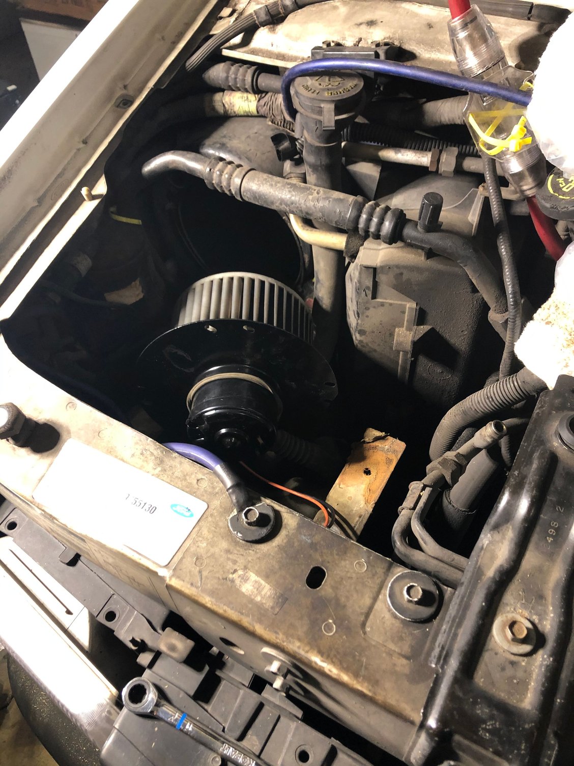

Relay checked out ok, went and bought new fan, it has a wired plug. Just un clicked old and plugged in new, works on every speed, doing install to
morrow
