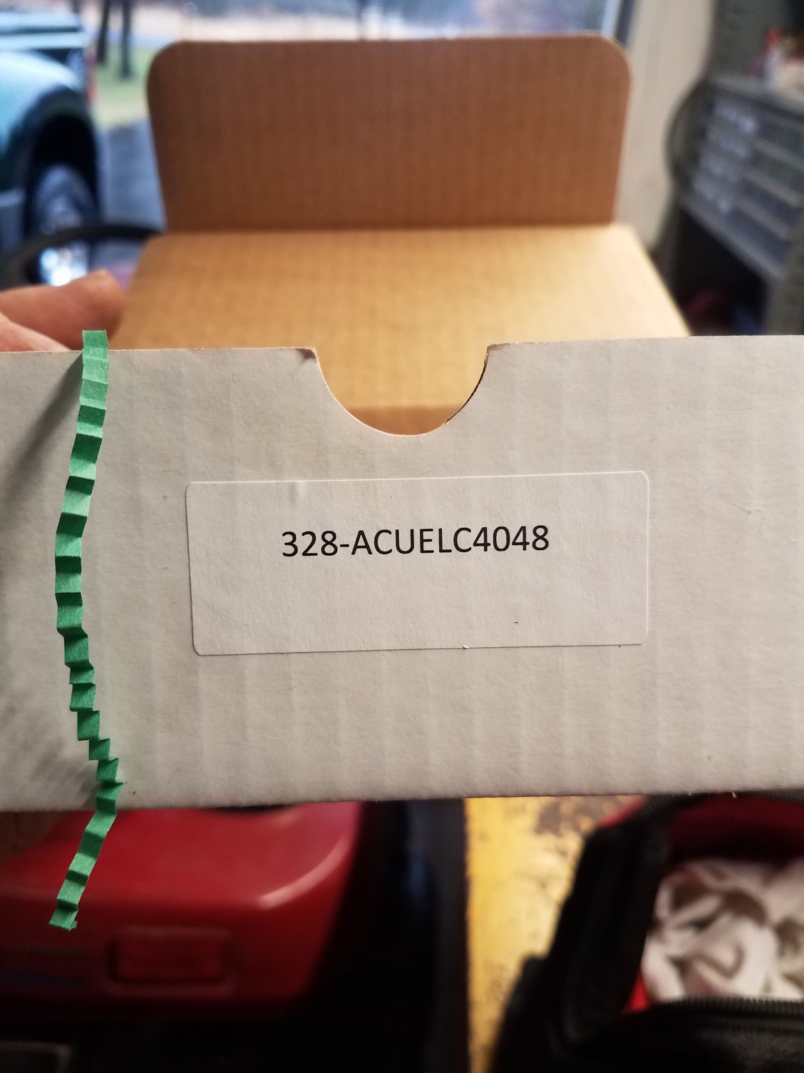

Buy the kit from accustrip and do it yourself! The biggest headaches this truck has ever caused me was dealers screwing up the coolant check procedure, using wrong strips, adding wrong revitalizer, flushing and putting the wrong coolant back in. It's not hard to do and this kit has enough to check both systems. Did it myself this time. Kit comes from accustrip.

thank you for the tip. I've heard many complaints & headaches from having the dealer mess simple things up.
