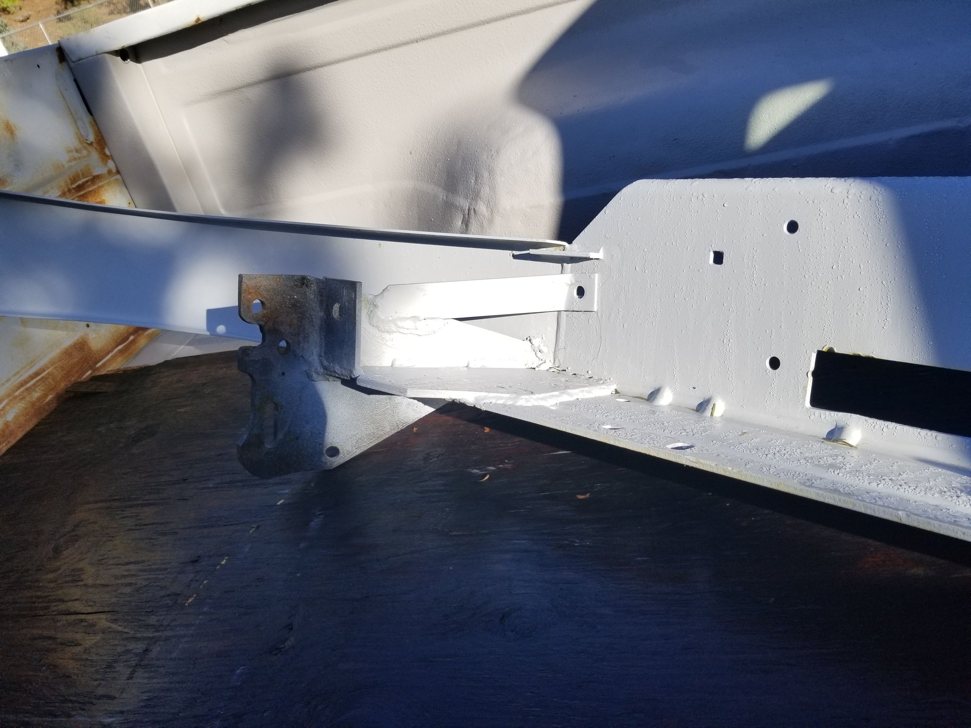

That looks like the bumper I have, I personally removed it from the truck. The brackets are welded to the truck directly, there are not bolt on pieces to adapt it to the frame.
That's kind of why I am confused.
Here is the driver side

Definitely fabricated on there. Name:  photo402.jpg
This is the NOS 80-86 kit I scored off eBay. The bolt holes circled are where it should bolt onto the winch bumper. You should have holes near where the custom mounts are. If so, you could probably just cut off the other mounts and bolt it right up.

Thanks for posting pictures, that really helps in figuring out how to move forward.
The rest of the bumper is in really good shape so my 2 options are cut it all off or just cut back enough to add brackets that will work with my frame.

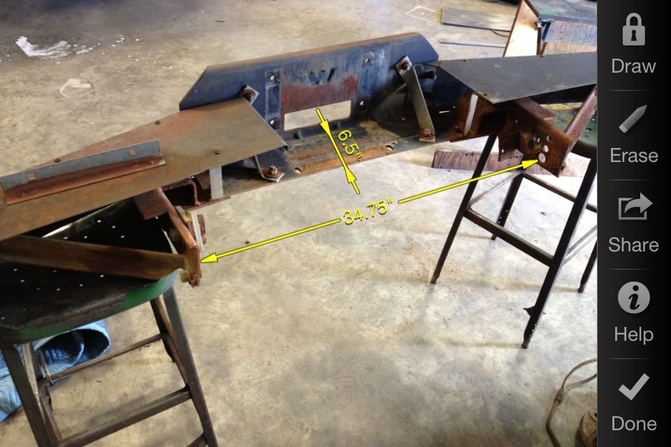

Found this picture that I had saved for when I reassemble my bumper. This bumper appears to also have the 73-79 brackets. Thats probably the best one I can come up with, short of going and looking at my disassembled bumper
