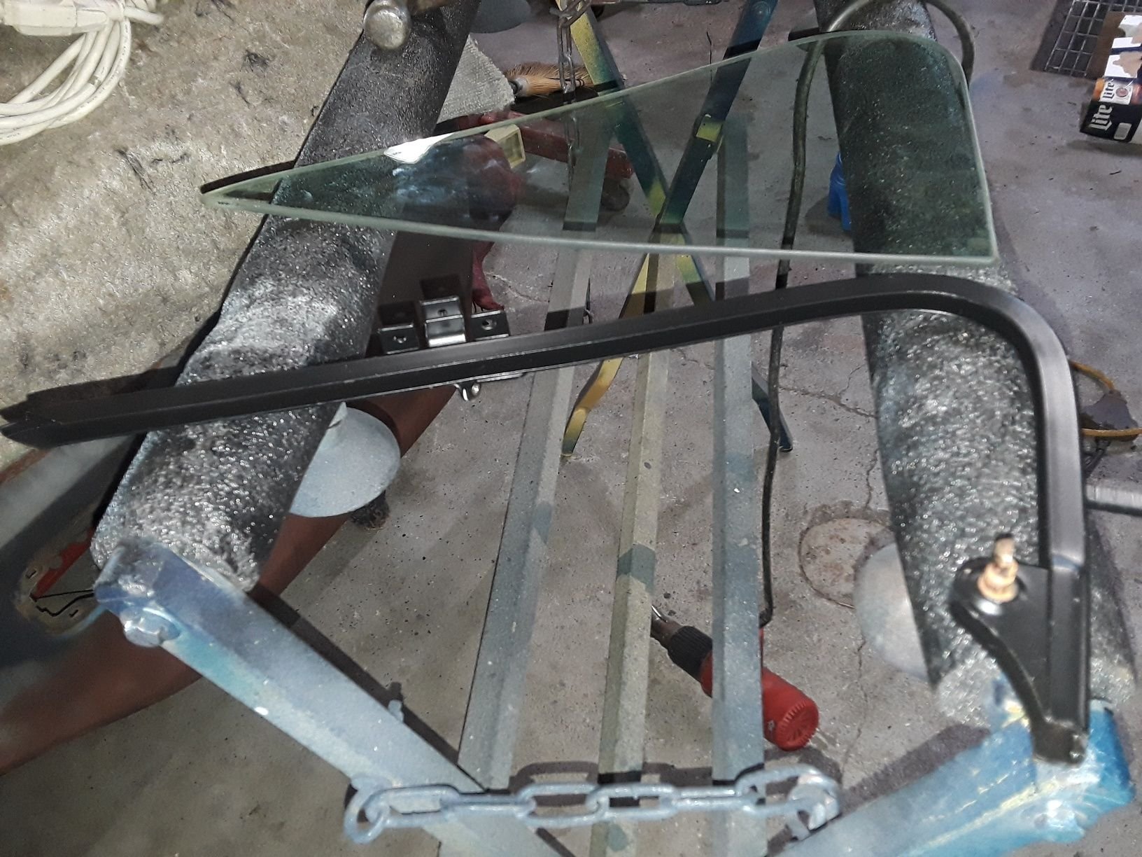

Well, just in from the garage with the parts the auto body shop ordered. Anyone see an issue here? Placing an order with one of the referenced-above companies. Not throwing Summit under the bus; could be that the person made a mistake during the order or that the wrong parts were shipped. Oh, the joys of old truck ownership; patience is mandatory...
New vs. old
This ain't right...

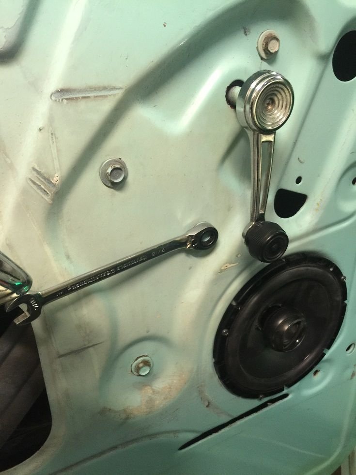

Just in from the garage and thought I'd post how I did it, which is a little different from the videos I watched. First I remove the two bolts holding the rear track; the other one is up and out of frame.
Then I removed the three bolts holding in the window crank assembly.
Doing these two steps allowed me to physically push the glass down and out of the way. No worries about room or hurting the window now.

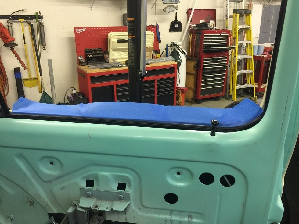

Then I put tape on the outside / new paint job, although if you're careful this step may not be required. There is a LOT of room once you take the glass out of the picture.

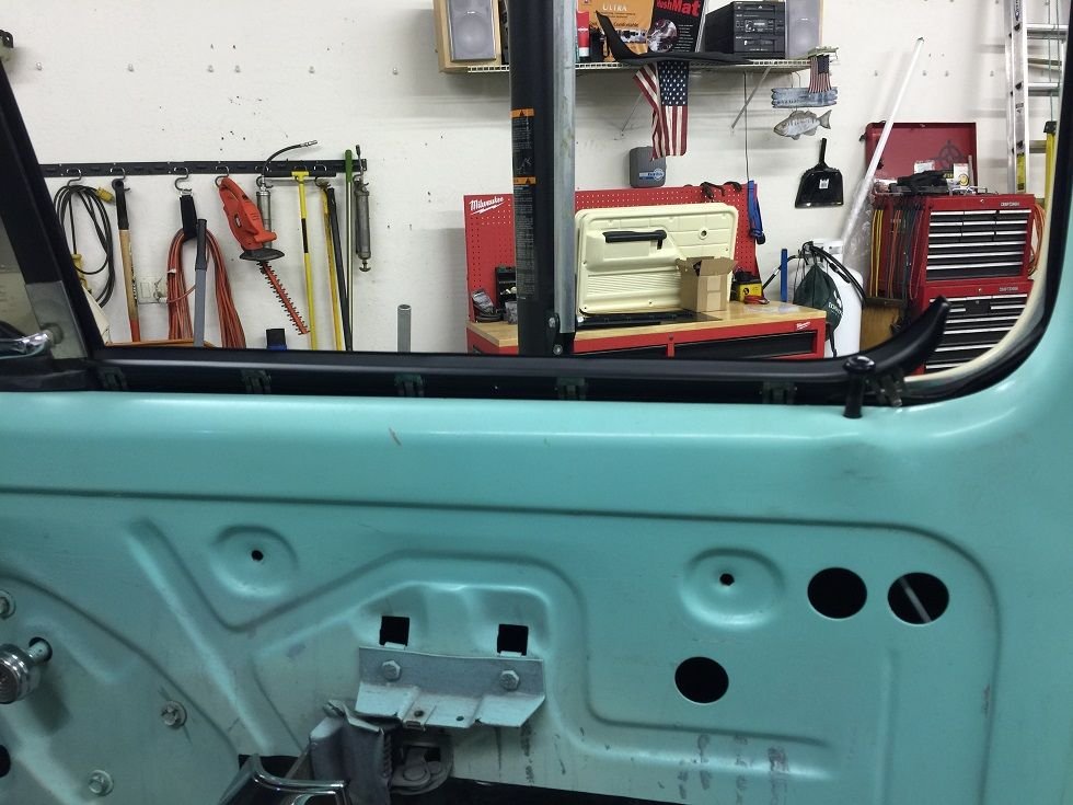

The two pads snapped right it. The only "funny" thing was that one of the pieces had a different clip pattern, which I discovered by simply trying it on the other (driver's door). Thought for a minute that we had a quality control problem.
Here is the final project complete. Took about 15- 20 minutes per side this way.
Hope this helps someone worried about doing it themselves. Thanks all for the supportive posts.
