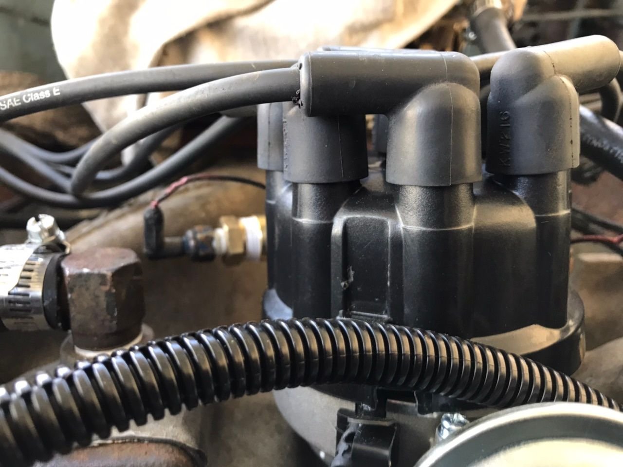

Just a FYI for those who have a Edelbrock intake and a Summit gauge set.
You will need a 3/8” x 18 Npt fitting from a auto store.
The rest from Lowe’s. 3/8” “T” from if you want to also use the OEM sender.
Pics will show how high it sits and the parts needed because the adapters that comes with the set will not it the intake.
Just a FYI for those who may need it in the future and not have to go back and fourth and get it done in no time.
Note the bag with the black packaging is from Autozone.
^^^^ Summit fitting won’t work.
^^^ Just giving the height.

With the mechanical temp sensor elevated in that tee I would assume the gauge will read a little low. Also that will make an air trap; crack the mechanical sensor when system is under pressure to bleed out the trapped air. I much prefer old truck plumbing to house plumbing 😊
Correct. I tried that setup years ago and it did not work very good, the sending units need to be in the flow. At least thats what I was told. It does make sense.
Thanks, didn't even think about that. I was just wanting the OEM gauge to work as well.
Guess I'll be changing it out.

I have an Edelbrock intake too. I put the mechanical gauge setup in the port where your tee is installed. Just need the correct adapter from intake pipe thread to sending unit thread with tapered seat. I have an aftermarket water neck as well which has a pipe fitting opening where I installed the stock electrical sending unit so the stock gauge would work. Both gauges seem to agree pretty well. Although with my set up, the stock unit reads temp on the radiator side of thermostat and mechanical is reading on engine side - thus they do not match well unless thermostat is open. As a side effect - I always know what the t-stat is doing. The pipe dope/sealant stuff is not needed on the mechanical sending unit; it actually seals by bevel - not by threads. It may also be detrimental for the stock sending unit - I may be wrong, but I think it may interfere with grounding through the body of the sending unit.
I must really be tired, I should have thought about that.
Yes that is a great way to know if the T-Stat is working etc.
Yes I know the pipe tape sealant is not needed but I always use it (old school I guess) and never had a problem with grounding but I do understand your point.
Maybe I can find a new neck and replace the one I have now.
Thanks again guys, really appreciate it,
