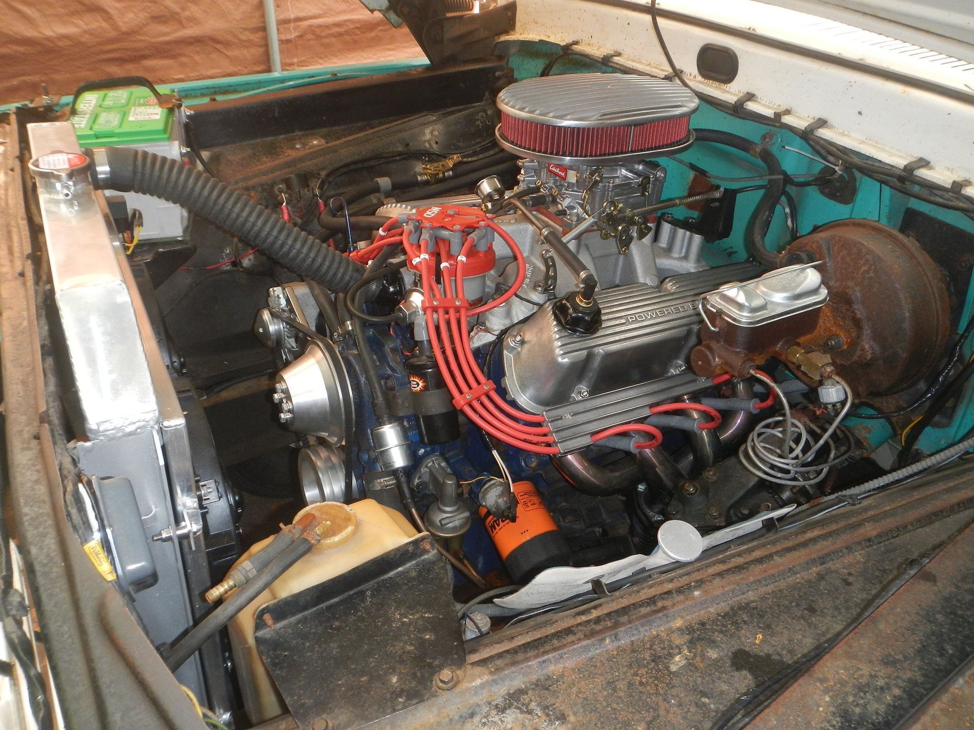

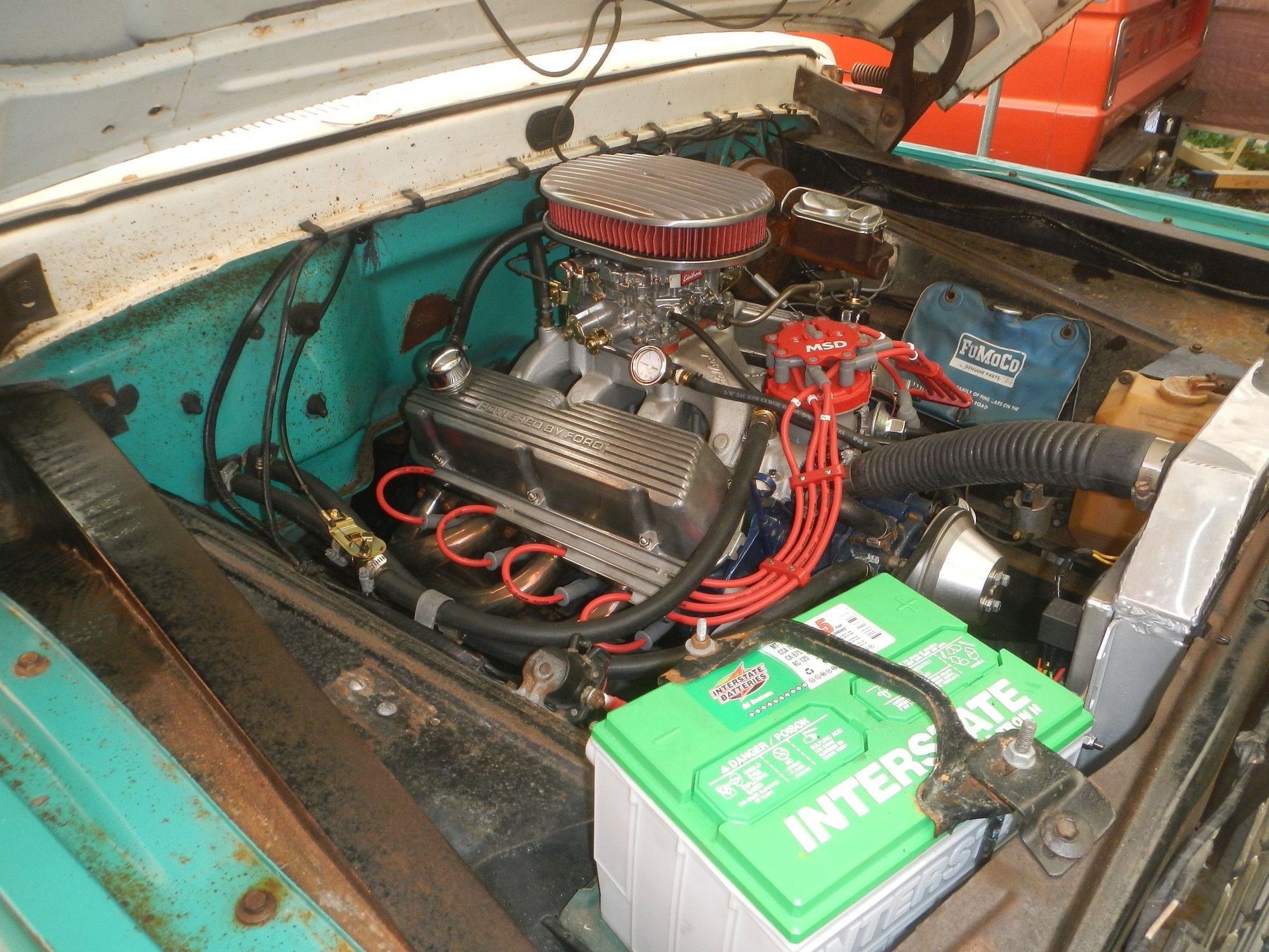

Need help with choosing the correct intake.
I have a new built 302 with 351W heads block is 20 over with COMPK31-414-3 Magnum 224/224 Holley 4 barrel shortie headers
I currently have a Weiand street intake. It was on the truck when i purchased it.
i found a SBF Edelbrock Torker Intake on marketplace. any good?
thanks for the help
