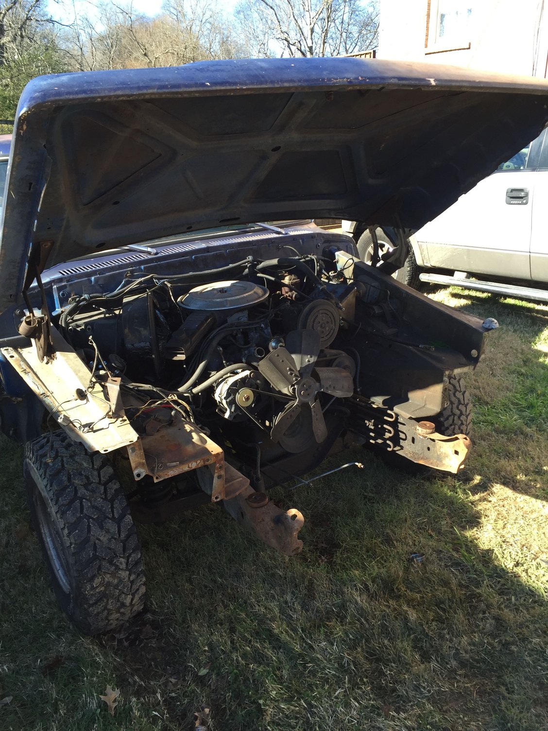

Who thinks I have enough hood clearance to put an air gap intake on here?

Did you have a factory four barrel? If not, some came with a factory four barrel (like Holley) and you could reuse your factory air cleaner. That would save you some room.

Mine had a 2 barrel intake with an inch spacer that had a vacuum for the transmission attached to it if that helps.

Do you know the total height of the stock intake with the spacer? I think potentially, you could do away with the spacer, then gain that back to use for 1 inch spacer or the air cleaner. Also consider running a dropped base air cleaner. Or a factory style like this. 1970's Ford Mustang Boss Pickup Truck Dual Snorkel Air Cleaner 4 Barrel Custom | eBay

I would say with the spacer it would probably be 4-5" but I'll measure it tomorrow. If I had $135 right now I'd definitely be buying that dual snorkel breather.

Yeah that's a pretty cool piece. But it was just an example I found. So it looks like you're not far off on the intake with spacer versus the Air Gap which is 6" tall or so. You could always put your engine in the truck without an intake and see how much clearance you would have. Then get the intake you can fit.
