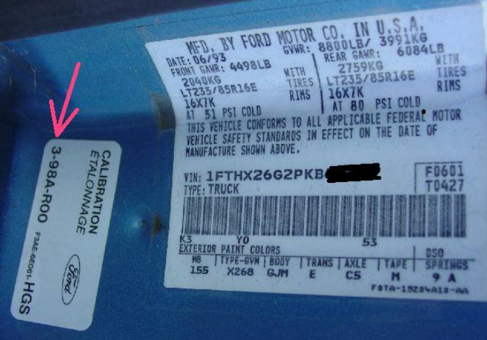

auto or manual, have you check for codes, would it start with old PCM, did you get the right PCM, can you post your calibration code, that is located on driver B-pillar, or driver door jamb, our gurus can tell you which PCM is compatible for your truck
pic courtesy of subford

Here's my info
Anyone tell me what computer board this truck should have in it?

CALIBRATION: 0-51F-R02
PROCESSOR AND CALIBRATOR ASSY (PCM)., (EEC-IV)
Number on the unit is F0TF 12A650-AB (ENGINEERING NO.) and the Ford part number is F0TZ 12A650-AB (SERVICE NO.).

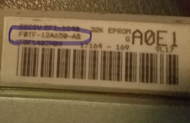

Here is the tag on the remanufactured pcm that I installed in the truck. Does it seem correct?

Yes it does.
Looks like it’s a match to me too.
