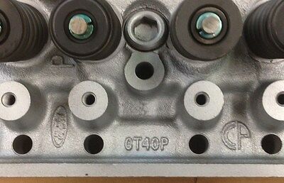

You shouldnt need a specific year as there wasnt changes after 97 (not any big ones anyway). Assuming it is in fact out of an explorer, this should be pretty easy. On the corner of the head near the spark plug it should say GT (96-97)or GTP (97-01). Yours, 'should' be a P head, other identifiers are 4 bars on the "front" of the head, and GT40P under the valve cover. These heads were only used in 97.5-2001 explorers. If you do not have P heads, the GT40 heads have casting number F1ZE which is specific to explorer (only the number not the head). Chart at the bottom in case yours turns out not to be an explorer engine.

Not sure about the P heads, but GT40's were also used in marine applications for years.
