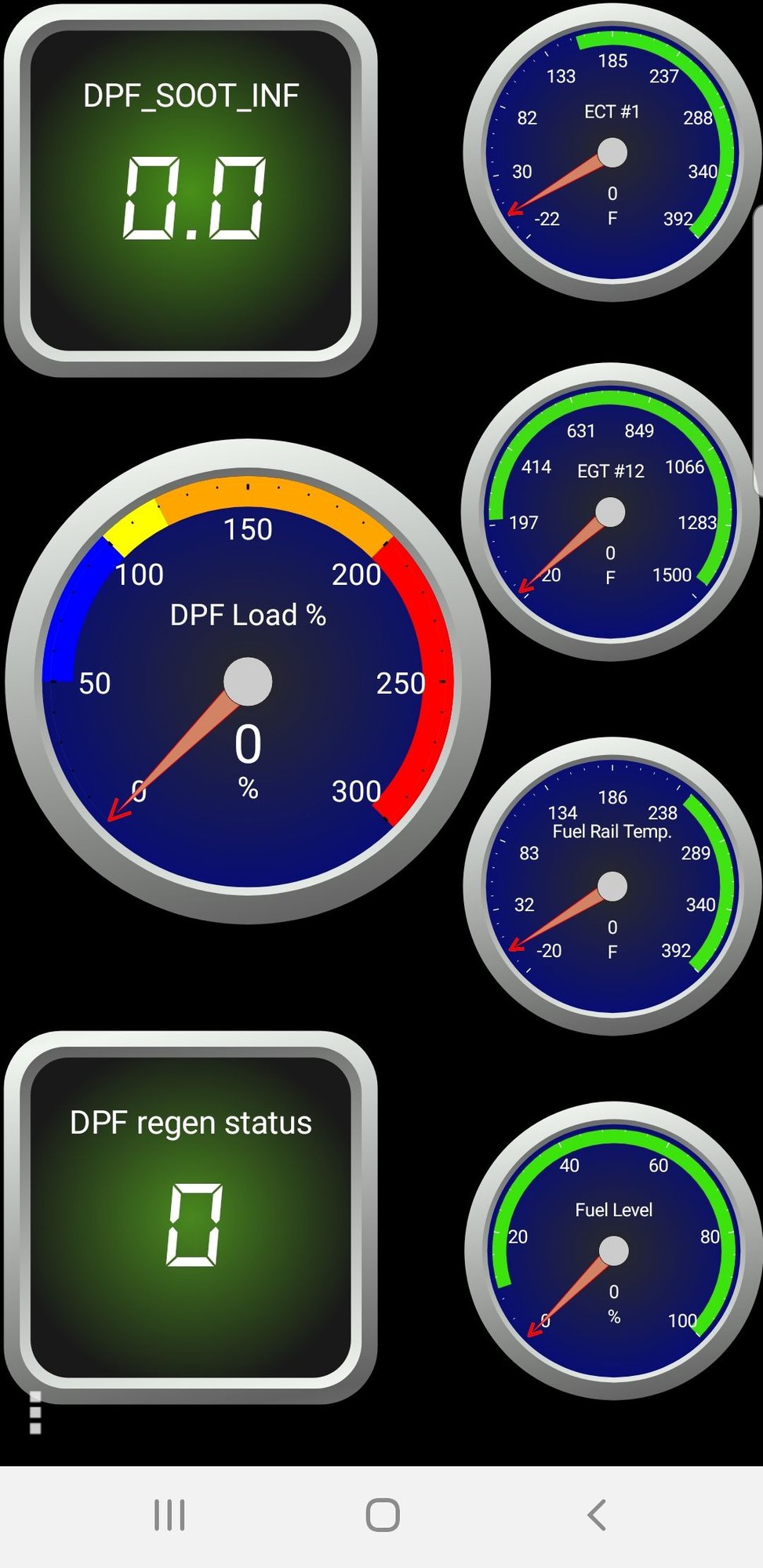

So I've seriously been considering getting forscan for my truck so that I can load the dpf screens and perform manual regenerations. The one thing that's bothering me is that I have a sct x4 tuner hooked to my truck, will forscan and sct work together?. I just run the canned street tune for now because I like the way the truck handles so much better than it did stock but it's still pretty mellow. I haven't been able to find much to the topic of forscan and tuners together, even the f150 forum has been pretty slim on information.

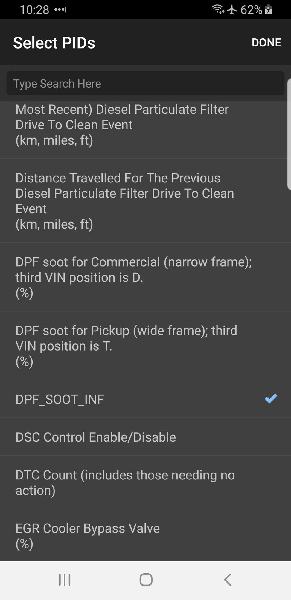

Originally Posted by jav_eee
Can you please explain number 2?
DPF soot for pickup, vin position...?
I’m traveling on a ship for the next two weeks so don’t have my notes handy. As I recall there is a letter that identifies whether the engine is in a pickup vs other use truck (ie commercial). There are different PIDs based on that letter

So tell me, can the distance from last regen, which we know is to be set by Ford at 500 for a mandatory regen, be altered? I can almost always go over that mark. My last one was 652 miles.

The short answer is chassis cab 6.7’s and pickups are not created equal, besides the power on chassis cabs being derated, the DPF and SCR positions are swapped, and with that I assume are other parameters that are tagged and handled differently.

My 2011 doesn't have the OCR enabled. I have to rely on the computer deciding when to clean it (isn't that convenient!!!). I am getting the message that it needs cleaned. Fuel is full, DEF is full, no codes, drive and get it up to temperature on the freeway, it will go into cleaning mode for about 20 miles then stop ( goes back to filter needs cleaned message on dash). Won't go back into clean mode again until I drive it the next day. I have downloaded FORScan and have ordered the recommended cable FORScan says to use. Once I receive the cable, my plan is to connect to the truck and enable the OCR. I've spent more money in fuel trying to get it to regen then I would have if I just paid to have the OCR enabled.
