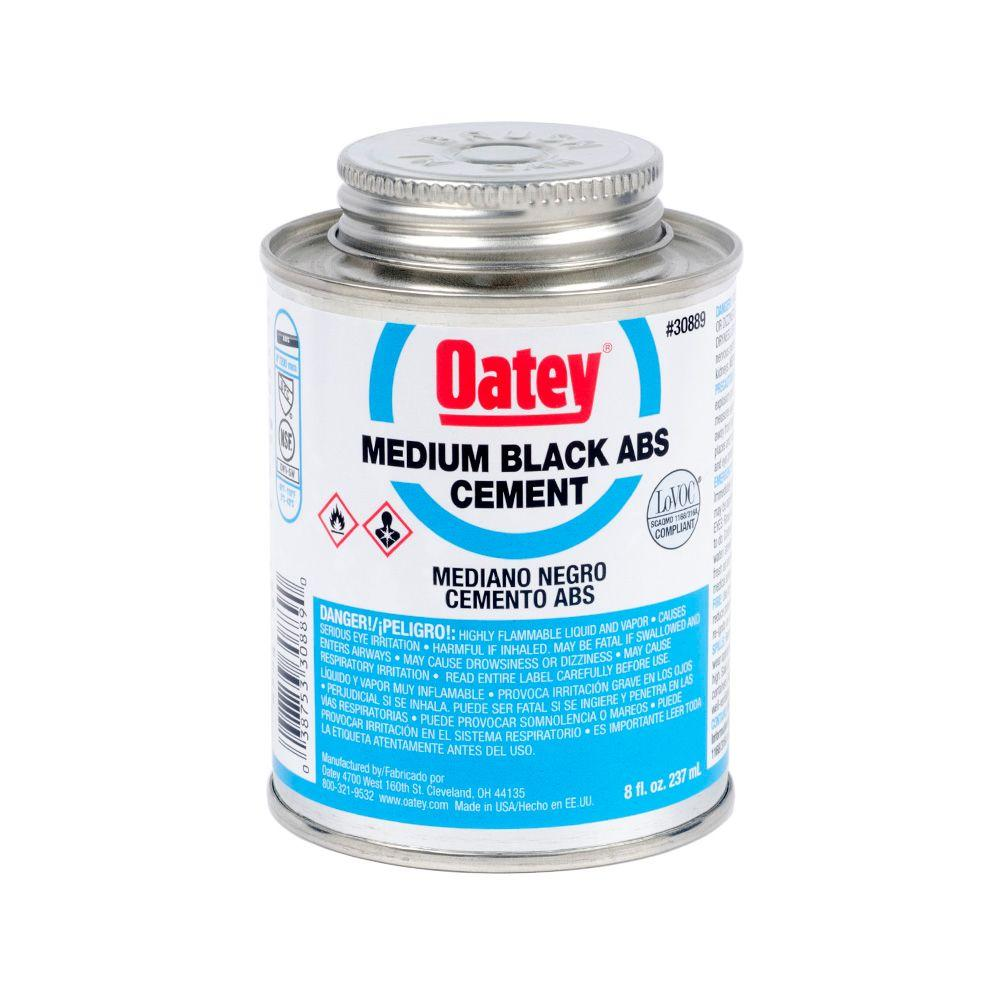

Hey guys, I had an Idea for repairing and reinforcing old door panels. I have searched through many old posts with very crafty ideas on the topic, and I was wondering if
anyone ever tried using abs pipe glue to adhere some reinforcement pieces to the backsides? I have used that glue before on piping and it is very cheap $5.29 for 8oz. https://www.homedepot.com/p/Oatey-8-oz-ABS-Cement-in-Black-308893/100345366
Also, I found some plastic segments in all different shapes and sizes at mcmaster-carr. "Impact-Resistant Easy-to-Form ABS Sheets, Bars, and Strips" https://www.mcmaster.com/abs
For instance, there are plastic 'rods' of different diameters, such as a 1/14" rod at $12.50 per foot. If you sliced it into short disks and milled them out a bit, (maybe set up a jig) they could be replacement posts. Or perhaps an abs pipe sliced into 'tower' sized disks with a metal 'cap' on top, drilled or cut for the plastic posts. A 1" wide X 1/4" thick strip could reinforce other areas and is only $1.57 per foot.
Your money would go a long way with cheap materials like this. Plus you don't have to cannibalize another panel for the towers, and you wouldn't be transplanting the same weaknesses into the panel. I believe you can form the plastic with a torch too. don't know if the glue would cause distortion due to being too strong though. Has anyone tried this?

I was JUST reading on another forum somewhere the other night where someone was saying they've used clear CPVC glue on interior plastic to make a repair but I can't remember where I saw it (I've been going without sleep a lot lately and it has a negative effect on the 'ol memory).
At least you're thinking and trying to come up with some inexpensive alternative fixes to save guys some money & material. I'd be tempted to experiment on a few broken pieces at a local junkyard to see what will bond effectively and what won't.
Formable plastic might be a nice material to use in some applications. It sounds similar to the plastic they use when you've had surgery on your hand etc and they take a sheet (usually white) of it and cut it then heat it to shape & form it to the contours of your hand & wrist etc. I always thought material like that would be handy around the garage too.
CPVC glue and ABS glue are both excellent products for joining plastics. I used to do a lot of pipework when I worked in heavy-industry and they bond really strong. They are solvent-based however so keep that in mind. I would definitely also buy a small can of ABS/CPVC cleaner for spot cleaning and to prep surfaces or thin/dilute the glue(s) as needed. For the cleaner (and CPVC glue if that's something you might consider as an alternative) I'd definitely go with the non-dyed "clear" formula (not the yellow or purple etc).
